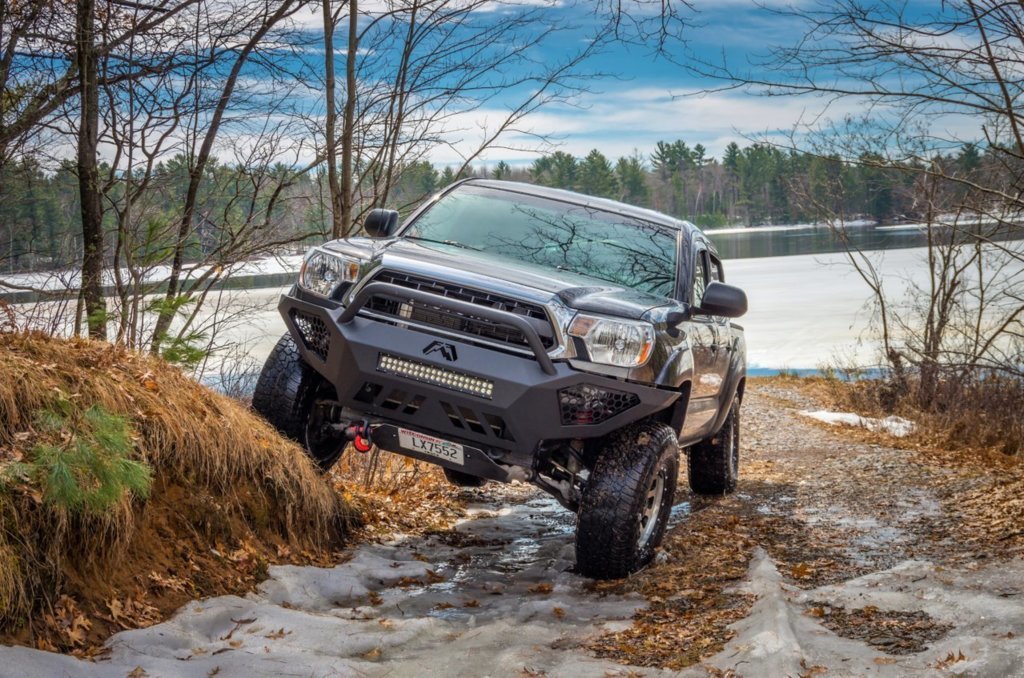

    Only company I can think of off hand that offers a thinner lightweight replacement bumper is fab fours. Or at least they did for the 2nd gen, not sure about 3rd gens.

    Here it is, the vengeance line: https://fabfours.com/product/toyota-tacoma-vengeance-front-bumper/

    @Larry Dangerfield 1/8" 65lbs thank you, that's pretty much what I'm after. Never liked FF bumpers but that one's not the worst. Still, I'll never buy it for $1800 and I have a 2.0 gen
