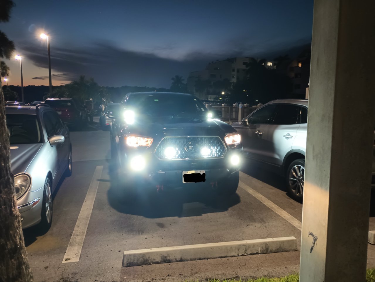

    This is correct.
    It appears you have put PnP LEDs in your halogen fogs which are designed for halogen bulbs. In the picture it is pretty obvious they are not working correctly with glare above the cut off. This just creates glare to oncoming drivers, poor performance and ineffective for the purpose in fog, instead you get lots of scatter which makes people think they look better if they don't know what they are looking for.
    If you want to run LED fogs, you need an LED fog assembly, many if not most for the Tacoma are covered in the SAE fog thread. I'd highly recommend Diode Dynamics SS3s or Elite fogs. For best poor weather performance I'd highly recommend selective yellow. All covered in the SAE fog thread here:
    https://www.tacomaworld.com/threads/the-led-sae-j583-fog-pod-fog-light-review.554813/
