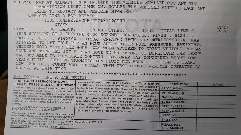

    Just got home from the dealership. The codes thrown were P17BB, B1244, U0126, U0163, P160300 and B160A. They also found that it was .5 quarts low. Which isn't very much but probably didn't help the situation. Traffic was pretty shitty so I wasn't able to feel if there is a difference.
