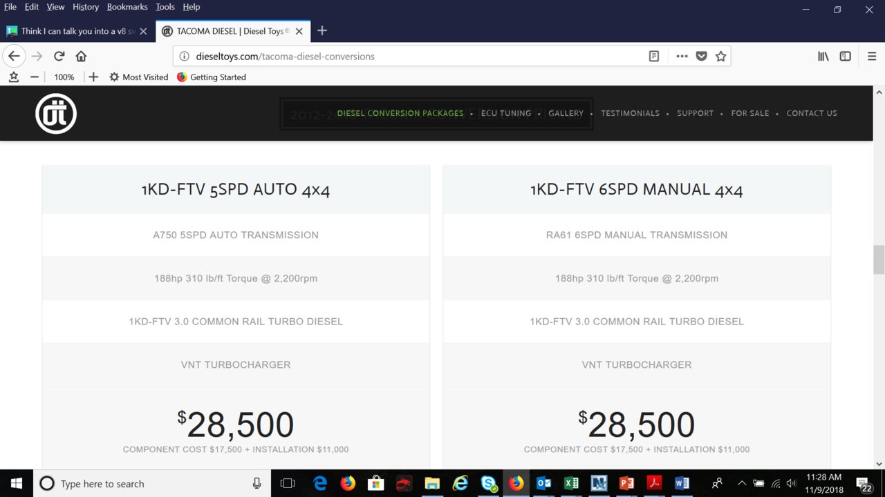

    Unless you have a magical black box that can convert GM ECU to Toyota ECU then none of that stuff is gonna work, as it's all controlled or prioritized by the ECU.
    You cannot, with a straight face, say the only thing you need is a rear axle to run an additional 100+ HP and 100 more lb ft of torque.
    You need:
    A transmission
    Output shaft
    Transfer Case (if 4WD)
    Drive shaft
    Front Axle
    Front and rear differential
    New wheel sensors with correct encoders (must have to communicate with new ECU to provide VSC)
    New front suspension
    Frame modifications
    And that is just the main items. We could talk about gauge clusters and instrumentation and go from there.
    Now, if you have a 2WD access cab SR model, and you wanted nothing much to work except your engine, then it would probably only cost $15K or so to do, not including labor.
    Here is a screen shot from a reputable supplier for a new Tacoma Diesel conversion. This is $28K on TOP of the Tacoma cost, for a total cost of around $70K. I would expect the price to be even more to do a V8 swap.
    boynoyce and COOutlaw like this.
