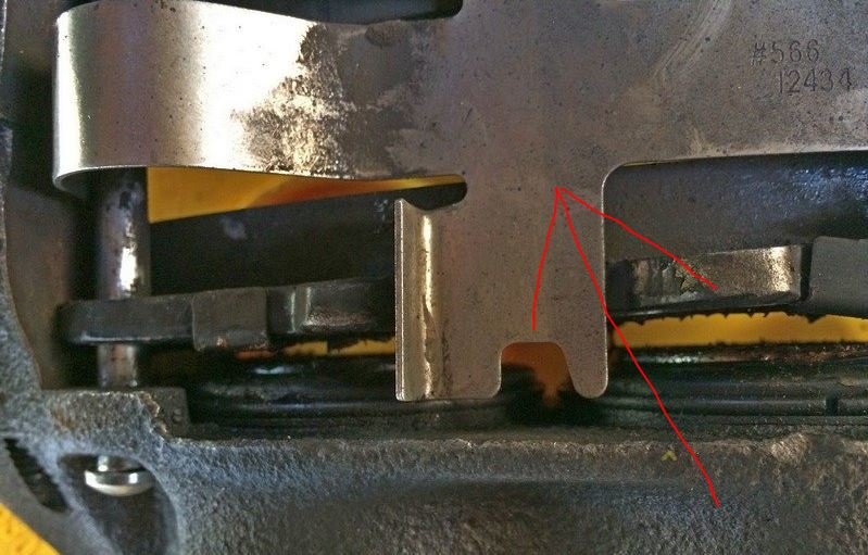

    Did my best to bed the brakes. While it's not NYC, where I live doesn't exactly afford the ability to go from 35-5 & back up a whole bunch of times unless I ran stop signs & red lights or seriously pissing off someone behind me.
    Question, from the pics I posted, do the pistons appear to be all in order? Pushed back, or as I call it, seated, correctly?

    Missed the question on the pistons on the calipers. If you pushed them back all the way you should be fine. Just use a C clamp and the old pads to push one side in and then use the other. Thats how I have always done it.

    K. Thank you. Having not dealt with new calipers before, I'd hate to think they were ok & come to find out they were defective to start with. Like I stated, just seems the pistons are seated farther out than on my old ones, even with their hanging on by a thread seals....
