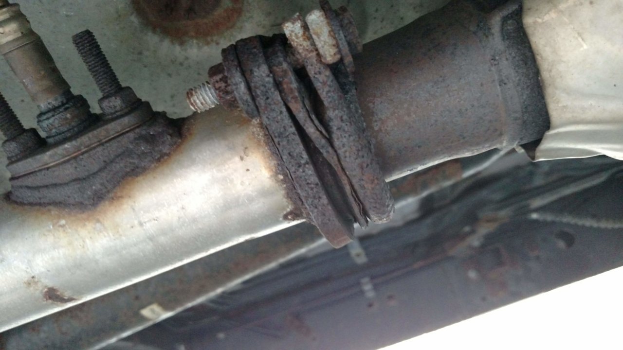

    3in lift (Bilstein 5100, AAL), Bull Bar with halogen Hella Fogs and High Beams
    Like a bunch of other people have said now. P0420 can mean a lot of things, and bad cats is one of the least likely (if you still have stock cats). That rear flange looks troublesome, thats where mine finally failed this year. Looks like someone tried to fix it at some point or something. P0420 also doesn't necessarily mean bad O2 sensors, you should get a separate code for that. However, if there is a leak then it's hard for the computer to tell whether or not the O2 sensors are good. Here's a couple videos for I found helpful, hopefully you do too.

    There is an exhaust leak on this flange. I noticed someone tried to fix this when my last exhaust pipe was replaced with what looks like some sort of U bolt. Is there a simple fix for this or will this require me to cut off the Cat flange and weld a new flange then getting a new gasket and then bolt the exahust and cat flanges together? I am not a welder so that is not an option to do it myself? How much would a shop charge to do this as well? Thanks.

    A good small welding shop shouldn’t charge more than $100 I would think. Or you could see if you have any friends that can weld. I just did this same thing on my truck the other week and I am by no means a “great” welder, but hey it holds and there’s no leaks.

    Those flange bolts loosened. You need to take that apart, toss the old gasket and get a new one. They are $6 from AutoZone.
    Clean up the flange face, new bolts and gasket and I bet your 420 code goes away.

    Nah look at the actual flange, it’s all deformed, tightening it more probably wont fix it. I had the same problem. Even tried one of those bolt on flange fixers and it didn’t work cause the actual flange was bent, rusted, and wasn’t sealing well.

    Shouldn't the deformed flange be the same size as the exhaust flange?

    It’s the same size yes. But the metal is not uniformly thick anymore due to rust. Therefore you’re having trouble getting even pressure on the gasket causing a leak somewhere. A new gasket is a good place to start since they’re cheap and you’ll need one no matter what. But I think you’ll find that when you unbolt the the flange is gonna fall apart more. You want to have to relatively flat and smooth mating surfaces for the gasket to sit on.

    That flange is shot, no way it'll seal for long anyway. I haven't asked in years and years but muffler shops used to not carry any flanges because of the wide variance.
    as an aside: why isn't there a pipe standard for exhaust? A little late now but it has been a expensive headache to match into a system.

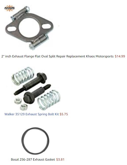

    Thinking of trying this. What do you think? Using a split flange with spring bolts and a new gasket.

    Still gonna have an exhaust leak.
    I think you would be further ahead by taking everything apart and beating that flange flat. With a hammer.

    Yeah don’t think that’s gonna work either, I tried something similar. Leak was still there. Even pressure and a flat mating surface are super important.
    Has anyone on here though about putting an o2 sensor bung before the flange?? That would eliminate this oh so common problem of leaky flanges causing codes and failed inspections...
