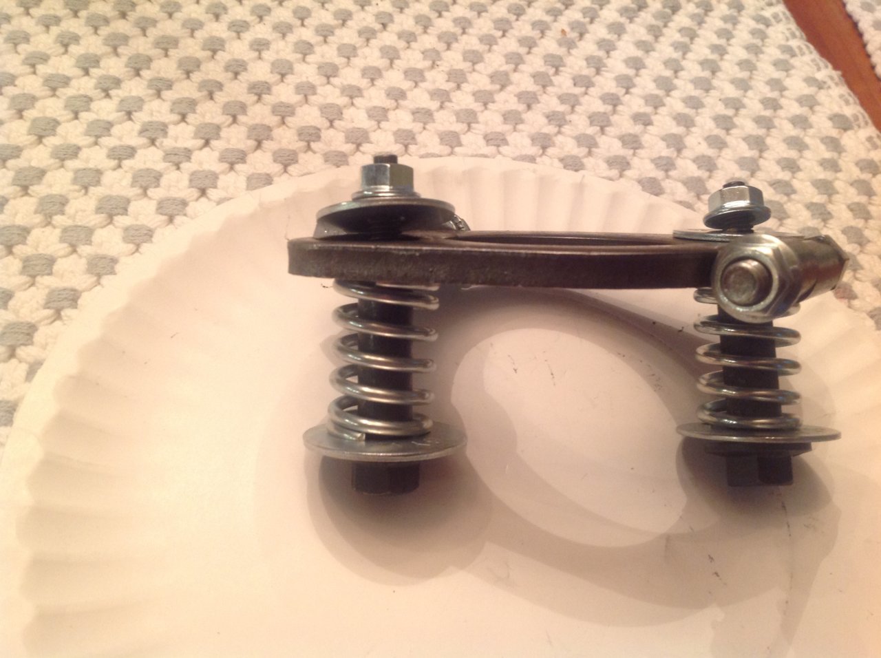

    I think I am going to try the split flange, spring bolts new gasket for shits and giggles. I will def need a new gasket so why not see if this works. Problem is Amazon and all other places I have looked for exhaust spring bolts tell me they are not compatible with my 2003 Toyota Tacoma 3.4L. I don't get it. Surely they will work won't they? The ones I show in the picture are often bought with the split flange.

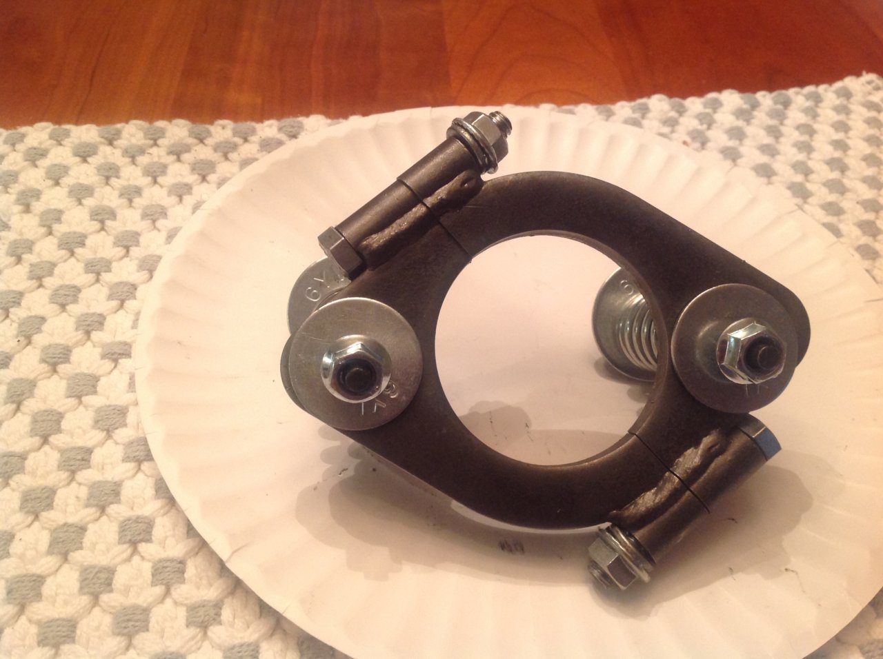

    The springs will preload the nut and bolt. I wouldn’t be super worried about it loosening as long as things are the right length.

    Well here is the setup I will be going with. Obviously imagine another flange connected to it lol
