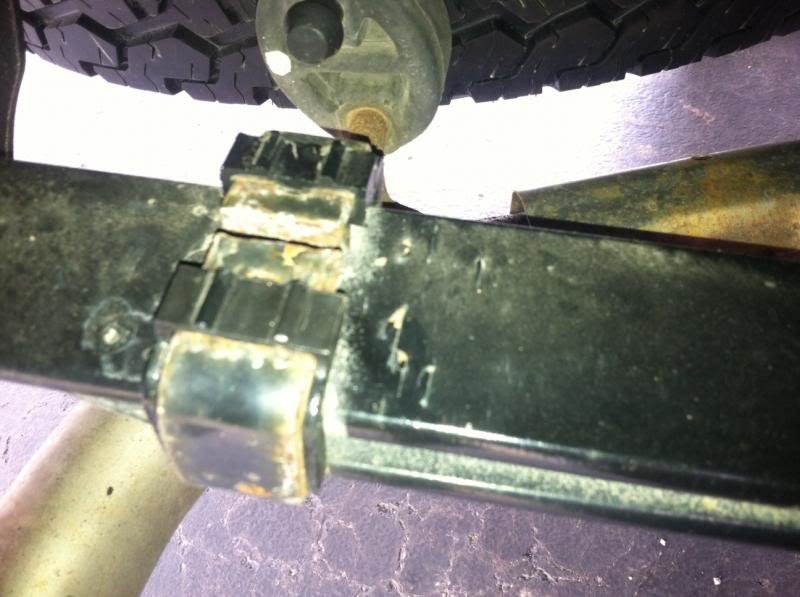

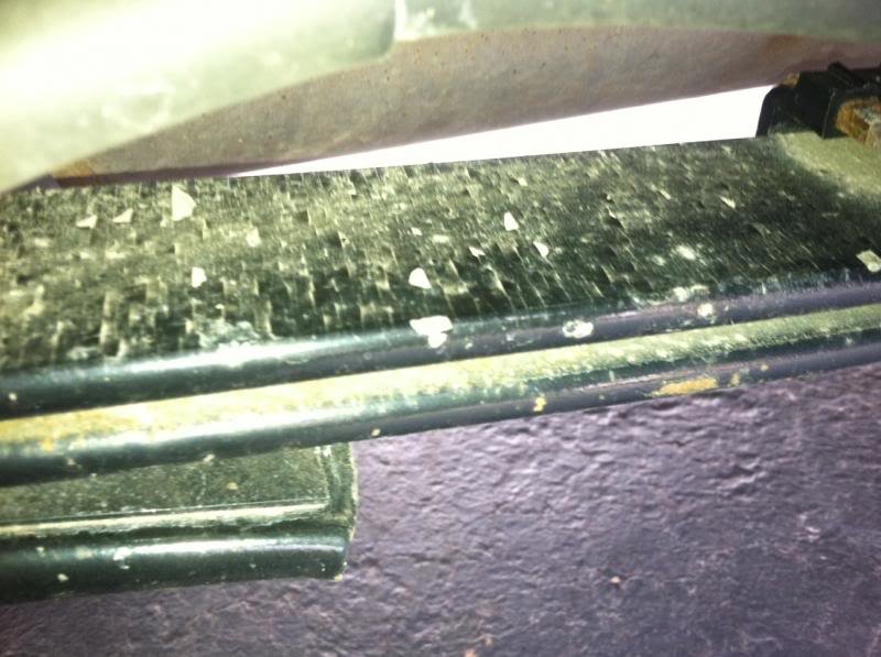

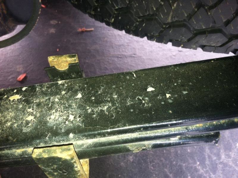

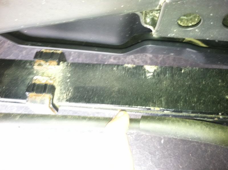

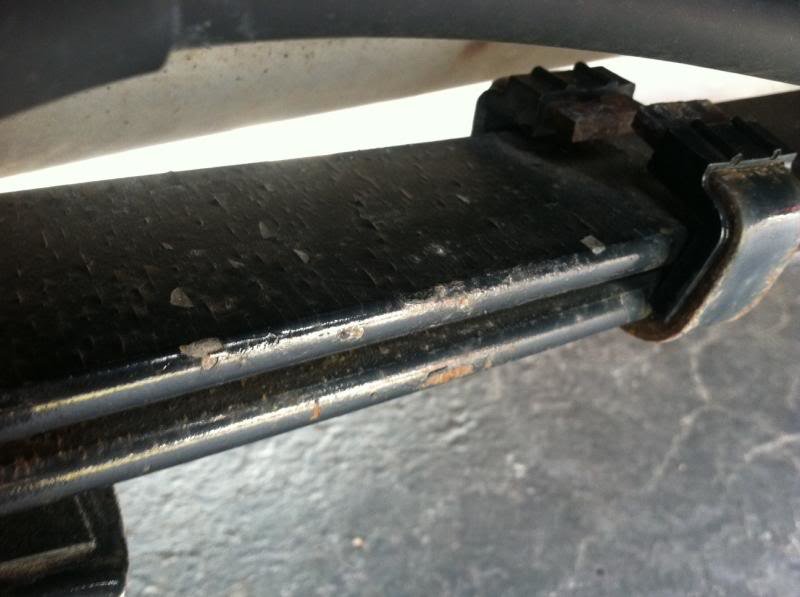

    was outside today, and was standing near my truck, when something caught my eye, the clip that holds the leafs together, is bent looking..... got down on my knees and stuck my head inside the fender to get a closer look..... looks like both side, the top leaf is about to snap...... yes i had a heavy trailer on it once, and it was cold (-20*f) i wonder if the cold and heavy stressed them to the breaking point..... (not going to say that that the dealer, oops) it might get me the tsb leaf pack for my 2012 off road double cab. see pics below, sorry they are blurry, my iphone camera sucks now

    passenger side front without flash, can see the paint is all broken, and stressed looking!!!

    Just looks like a crappy paint job starting to peel :notsure:

    idk, look at the shakle looking thing in the bottom pic, it is clearly bent up on the top outside?!?!?!

    Yeah, but look at your 2nd pic, one of your spring retainers is bent all the way opened. Those are just metal pieces bent around the leafs to keep the leafs in line, they aren't structural. When you're loaded down heavily, they aren't even doing anything. Don't get be wrong, the stock springs are junk but I don't see anything on your set that jumps out as OMG you're gonna die if you drive it. If you can get the TSB out of it, great, new leaf pack for you :)

    Here's the thing, if you were overloaded, you'd have been planted squarely on the bump stops. If you had an 800 lb tongue weight, you were likely not even riding on the springs at all.
    If you haul, get the TSB done, it's not a great fix, but it does help at least a little.

    The metal leaves that bend + brittle paint that doesnt = cracked paint on top of perfectly fine leaves.
    calm down OP.

    The bent clamp was definitely not caused by loading. As mentioned, it's not doing anything when on the stops.
    The top of that clamp is placed under stress when the spring is extended. Axle wrap during hard acceleration/shifting comes to mind as a possible cause.
