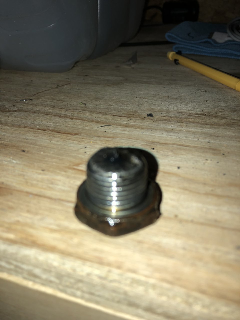

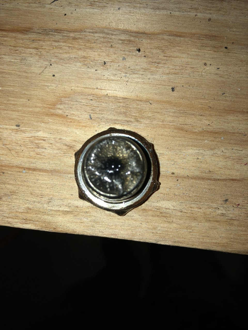

    Update: just drained the rear diff. This is what my drain plug looked like. There’s defiantly tiny flecks of metal in there. Mostly it’s a fine sparkly sludge. Is this about normal or should I be concerned?

  14. Jul 10, 2018 at 1:41 PM
    rnish
    rnish Well-Known Member
    May 9, 2014
    #129450
    8,594
    Peoples Republic of Maryland (USA)
    Tacoma 2nd gen
    King's, Camburg UCA, Dirt King LCA, armor
    Looks a lot like mine. However, mine was all black sludge, no sparkly bits.
  15. Jul 10, 2018 at 1:41 PM
    la0d0g
    Jan 25, 2011
    #49903
    19,891
    running for the hills
    For crawling not hauling
    Totally normal.
  16. Jul 10, 2018 at 1:41 PM
    #16
    VirusCage
    VirusCage Overwhelmed with fun
    Jul 5, 2017
    #223232
    1,468
    Bruce
    Allison Park, PA
    2017 TRD Sport DCSB 6MT 2015 Highlander XLE
    Hood deflector, window vent visors, stainless steps, kb voodoo bedrack, bed cubby cap seals, meso ext fuse cover, meso lower switch panel, 4xhella horns, power tray aux panel, 2wd lo mod, rear FU lights, bed led lights, BPF SKID and Hook, rear view mirror usb power ports, front and rear dash cam, front and rear cam anytime mod, cherry air freshener! Anytime 400watt, inside 110v outlet, BPF Skid plate, BPF shackle mount,
    There are many on here that know a lot more than me...but working on many cars, trucks, power equipment, and tractors...
    1. That SMALL amount of play, with no noise you have observed seems normal.
    2. The metal flecks you see, appear normal, when was the last time you changed the diff fluid before this? Sorry if I missed that.
  17. Jul 10, 2018 at 1:41 PM
    #17
    la0d0g
    Jan 25, 2011
    #49903
    19,891
    How many times have you changed it since owning it?
  18. Jul 10, 2018 at 1:45 PM
    #18
    koditten
    koditten Well-Known Member
    Sep 8, 2013
    #112077
    19,765
    Kirk
    Central Michigan
    04 trd x-cab 4 x 4 3.4l
    Reserected from the dead.
    Normal.
  19. Jul 10, 2018 at 1:56 PM
    #19
    88Taco
    88Taco [OP] Well-Known Member
    May 17, 2017
    #219261
    168
    Michigan
    Black 08 DCSB TRD Off-road.
    Rear diff breather mod. Block heater
    For those that have asked this is the second time I’ve changed the diff fluid since owning it. And that was 35k ago. Before anyone yells at me, I have not owned since new. I bought it with 130k on the odometer, changed the diffs and transfer case about 5k later when I did my first oil change. Fluid I just took out looked pretty clean. Way better than the milky grey sludge that I got the first time. I really appreciate everyone’s help. My other ride is a 2013 Focus ST and the folks on that forum are generally less helpful and more condescending. This really is a great community.

  20. Jul 10, 2018 at 2:42 PM
    #20
    Ackrite
    Ackrite Well-Known Member
    Nov 12, 2013
    #116467
    1,506
    SoCal
    1985 Toyota Pickup 4x4 single cab
    Here is a rough breakdown of what you should be spending if you were to do anything:
    ARB locker: $850
    R&P: $250
    Compressor: $200
    Locker and R&P install: $350
    New Balanced DS: $300
    And everything looks normal. From the play in the DS, to the fine metal shavings on the drain magnet.
