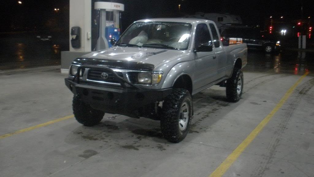

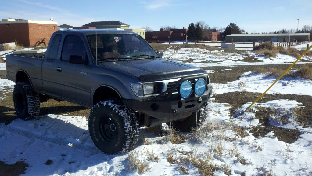

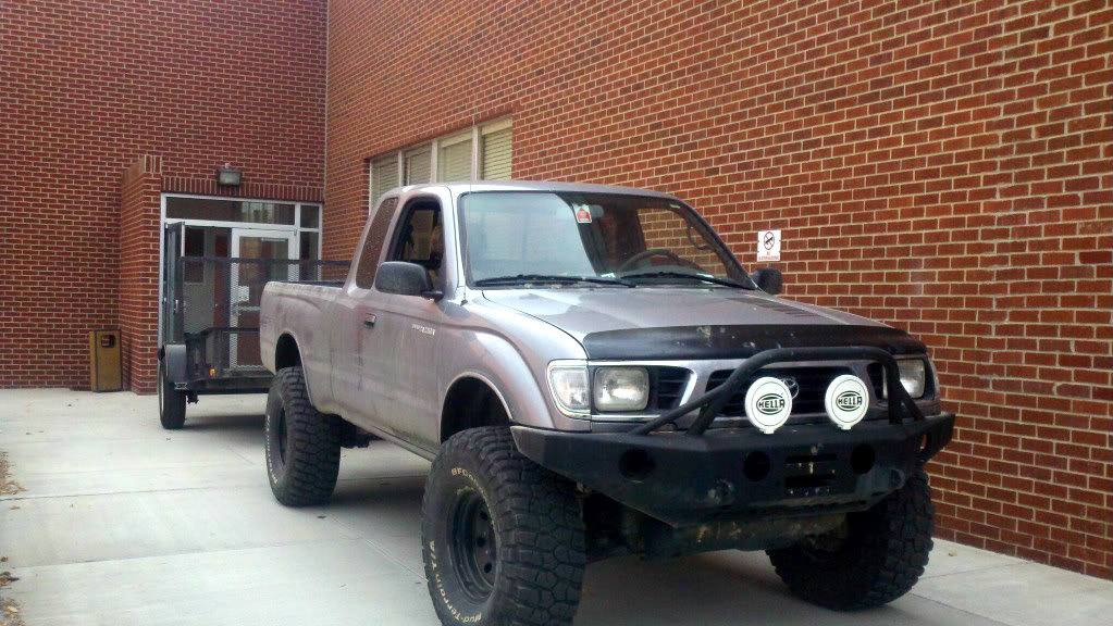

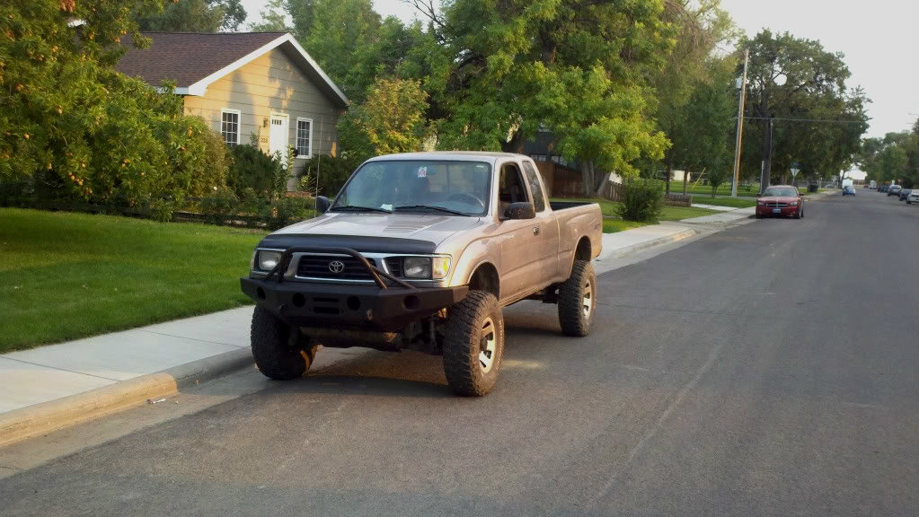

    255/85s are popular to run. basically a 33'' tire
    i ran 31x10.5s for a while till i found an epic deal on my 33x12.5s i don' thin it looks bad at all with a stock bumper...with the plate..the 33s definitely made it look better.
    31s..
    31s with plate bumper..
    33s..
