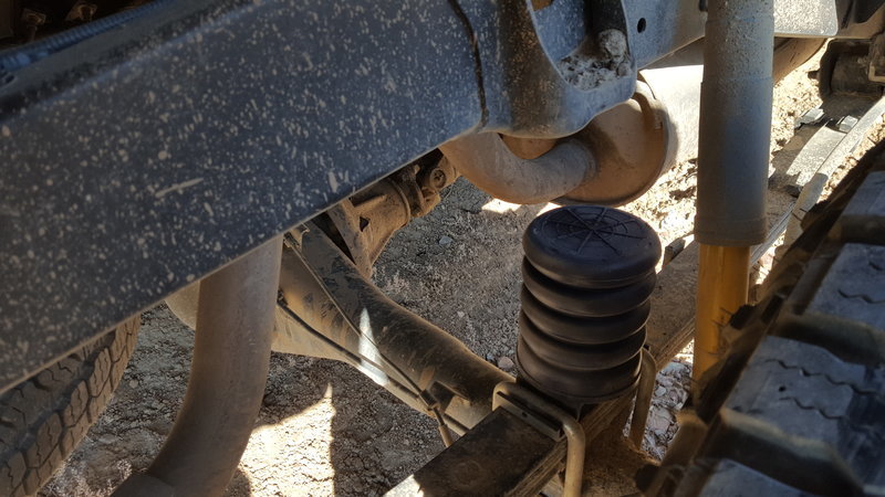

    Just an update. Called Toyota customer service and no luck with the recall. Looks like I am going to have to explore my options.....New 3 leaf pack by a different manufacturer, air bags, sumo springs or just new shocks to lift the back end up a little. Any ideas people?

    Do it right and put a new set of leaf spring in. Adding a crutch to crappy spring is not the way to go.

    Called the dealership, same thing, no go. I have been reading into the Hellwig helper springs. Seems like a cheaper option that might work. Thinking I might go with that and with some Bilstein 5100's.

    You can find OEM take off leaf springs on here for maybe $100, and likely get a whole set of OEM take off shocks for $150, too.
    Leaf install is super easy, way easier than airbag installation (which is pretty simple as well).
