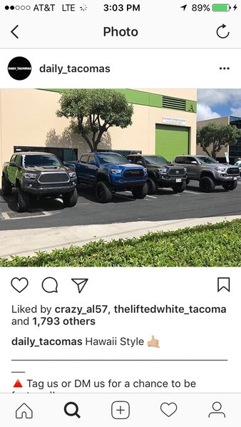

    He would not be the first the second the third or the fourth, they're probably 20 3rd gens with 6 inch lift on them just in Hawaii. They all run 35's with 20x12s. If you wanted to save some money but still go with the better 6 inch lift, go with the basic BDS lift, add Bilstein 5100s, OME springs, and Add a leaves in the rear with maybe a smaller block, with extended rear Bilstein 5100 shocks. This is if your truck is a 4x4. If a 4x2 look into Maxtrac 6" lift, much easier and cheaper.
