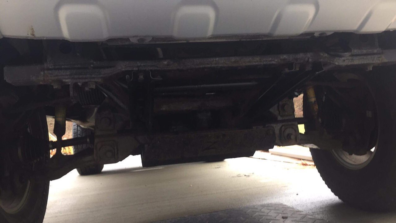

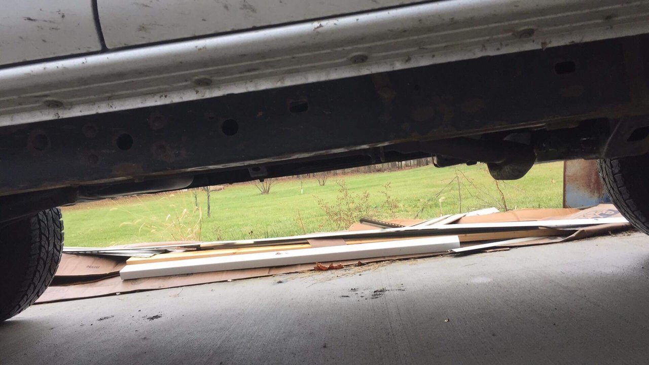

    Finally able to check out the pics, looks like 4wd with the cross member in. You have to remove that cross member from the lift and then fab up a new one.
    Pass.

    The crossmember has to be cut for 4wd
    So there is no cross member unless there’s no front drive shaft or diff
    Not possible to have 4wd with the crossmember in

    We are saying the same thing, the stock cross member from the frame has been cut and removed in order for the lift crossmember to be bolted on. Because of this, he would have to remove the lift cross member and then fab it up in order to go back to stock.
