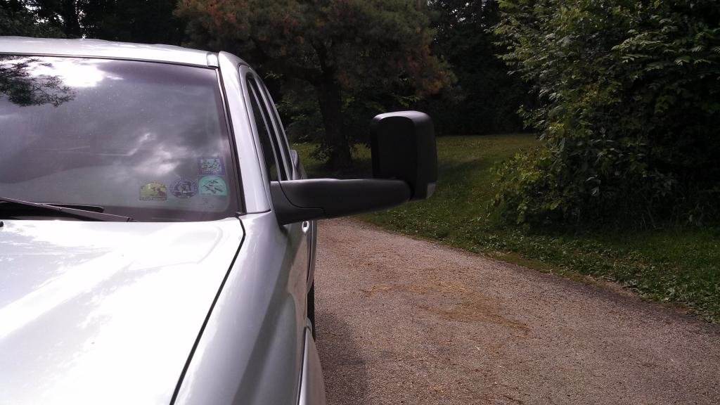

    Either should be fine. Get a Equalizer hitch or similar. Pull it in 4th (not Drive/5th). I like the Prodigy 3 brake controller. It's a little more but worth it. There's a thread w/ replacement mirrors for towing somewhere her on this forum. Those might be helpful as well.

    ProEFX heated towing mirrors FTW

    Those are pretty sweet mirrors I will have to find the thread on those. So you are thinking these trailers will be safe to tow with not to much trouble for the truck

    Those are the ones.
