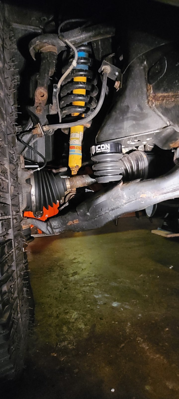

    Check these out for front bumps.
    I was looking at sumo fronts then found these Icons listed under Tundras for $100
    2" lift. No sway bar and rides stable.
