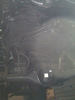

    I am looking at a 2013 Tacoma. 22k miles TRD Sport. The body looks good, but when I look under the truck I am concerned. I wasn't expecting this much rust for a Truck w/22k miles. I live in NE Ohio. The truck is at an independent dealer with a good reputation. This seems excessive to me. What are the risks? Dealer is asking $27,000.
    I would ask for new tires. The pic in the link shows cracking.
    Does the amount of rust and cracking of the tire indicate it has been sitting around outside for a while? Would you buy this truck?
    The link below shows some pictures I took.
    http://imgur.com/4qjpLSP
    http://imgur.com/a/OM9Xj
    http://imgur.com/UHuXNLW

    The frame is what I'd really worry about rusting. And those tires should be replaced if your gonna pay that much. If it were me I'd spring for a 3rd gen if I was buying used @ 27k

    Don't do it. That rust is very questionable. If you're gonna pay $27k, just put a few more grand for peace of mind. Not worth the risk if you ask me.
    If you can't afford a few more grand, then just wait for another used deal.

    That seems way over priced. As far as rust, look at the arms that go out to the front cab mounts and where the cross pieces meet the frame near the spare tire. Either way, I'm not a buyer at that price.

    Not sure why guys are making a big deal of the rust, because it isnt an issue with that truck... but the price is.
    The frame is clean with no rust from what I can see. Rusty leafs are not a big deal in the least.
