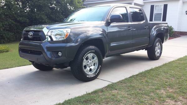

    Debaged myself before work one morning before heading to work. Took less than an hour. Cut them off with a guitar string, removed the adhesive with WD40, and then cleaned it up with soap and water. Quick rub down with polish and then wax. I suggest doing it in house, its easy.
