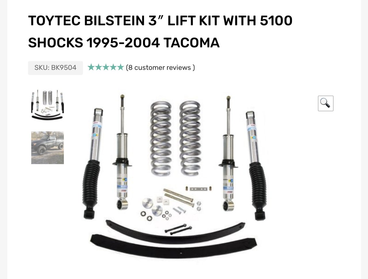

    so what do guys think about this kit Screen Shot 2019-04-17 at 11.00.01 AM.jpg

    I think everyone on this thread would agree. That's a proper solution if it fits the budget.

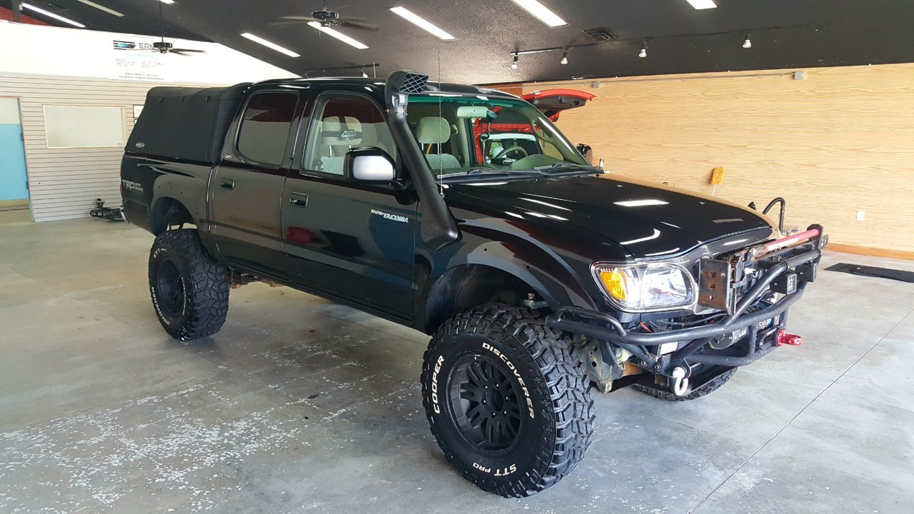

    2.5 or a tad more with the .25 top hat spacer.
    Rides stiff in the rear without a load because I also have the dakkar extra leaf. But when it's loaded down, it rides super nice.
    The entire kit was maybe $1200 without my TC uca's. But the 1st lift before this one, I ran stock shocks and stock uca's for well over 2 yrs with no issues, although not really suggested.

    Kit says 1.75 of lift. I guarantee it's over 2inches. Even with bumper, winch and skids.

    I think that's a good solution. What's the price on it? I think the only thing is doesn't (appear to) come with is a rear brake line extension.
    But depending on the price, you may end up finding it worth it to spend a couple hundred more and getting the OME kit listed above. You get ALL new springs, shocks, etc... I think it even comes with a brake line extension (but not a diff drop kit, iirc, which are like $30).
    If you are running on the original springs, we can safely assume they are worn out. Adding an add-a-leaf to worn out springs is, well, not ideal and really just a band-aid fix. The new springs are designed to handle the correct weight and have the lift you need (want) without making the leafs unnecessarily stiff (using the add-a-leaf).
