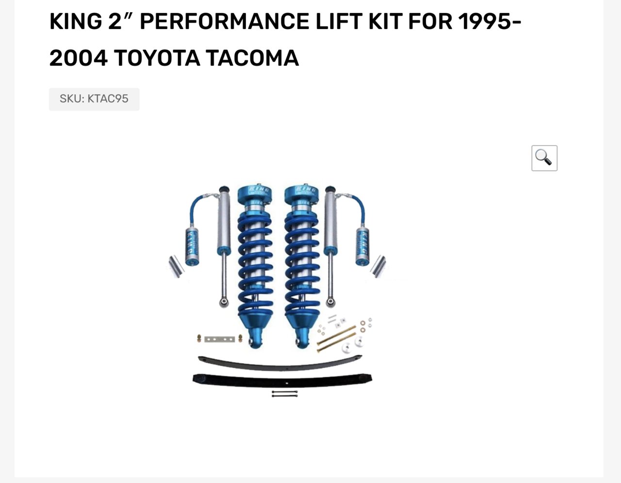

    Ok guys, I talk to a few guys and I'm going to take everyone advice to cry now with the price and be happy later, then crying later regretting not going to high quality. Im almost close into pulling the trigger on the King lift kit, its going to hit my build budget but I know I'm going to be happy on the long run. What you guys think. I won't be happy unless the community gives me a thumbs up lol .. I have respect for everyone here you thought and approval does matter

  8. Apr 18, 2019 at 7:18 AM
    #48
    Steve565
    Steve565 Well-Known Member
    Oct 12, 2018
    #269175
    639
    Steve
    Boise Idaho
    2019 MGM Tacoma off road DCSB
    When you go with king's your never will go back to the other one's.
    Your going to be very happy with them

    That’s a very nice set, you’re gonna love it! Do the coil overs come assembled? Some places have it as an option. I highly recommend paying to have the coil overs assembled if it’s an option.

    No I'm going to pay the little extra to get assembled and pre tune for what I want it for when I do get them

    Kings are a good choice. I'm not biased at all...:D
    I went with extended travel, Total Chaos UCAs and a diff drop.
