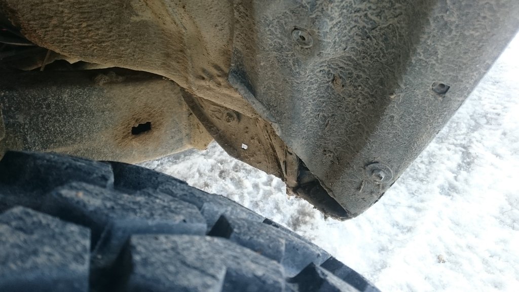

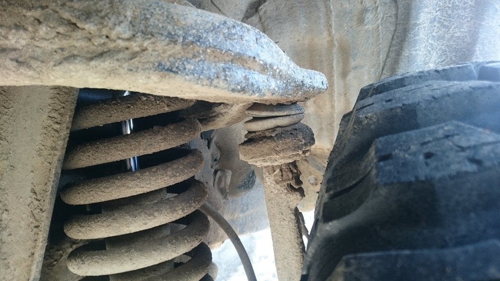

    285/75 is an 11.5" wide tire. Thats what im running on factory rims. It did ever so slightly rub uca before alignment.
