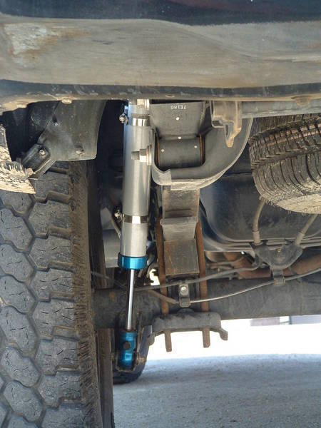

    yeah you need to run 17" rims... are you sure you dont want to save for LT??? if you go with the stage 2 pro comp kit, upgrade to the MX6-R remote resivor shocks...they are much better than the mx-6 shocks that come with the kit...they are only about $100 more each.[​IMG]
