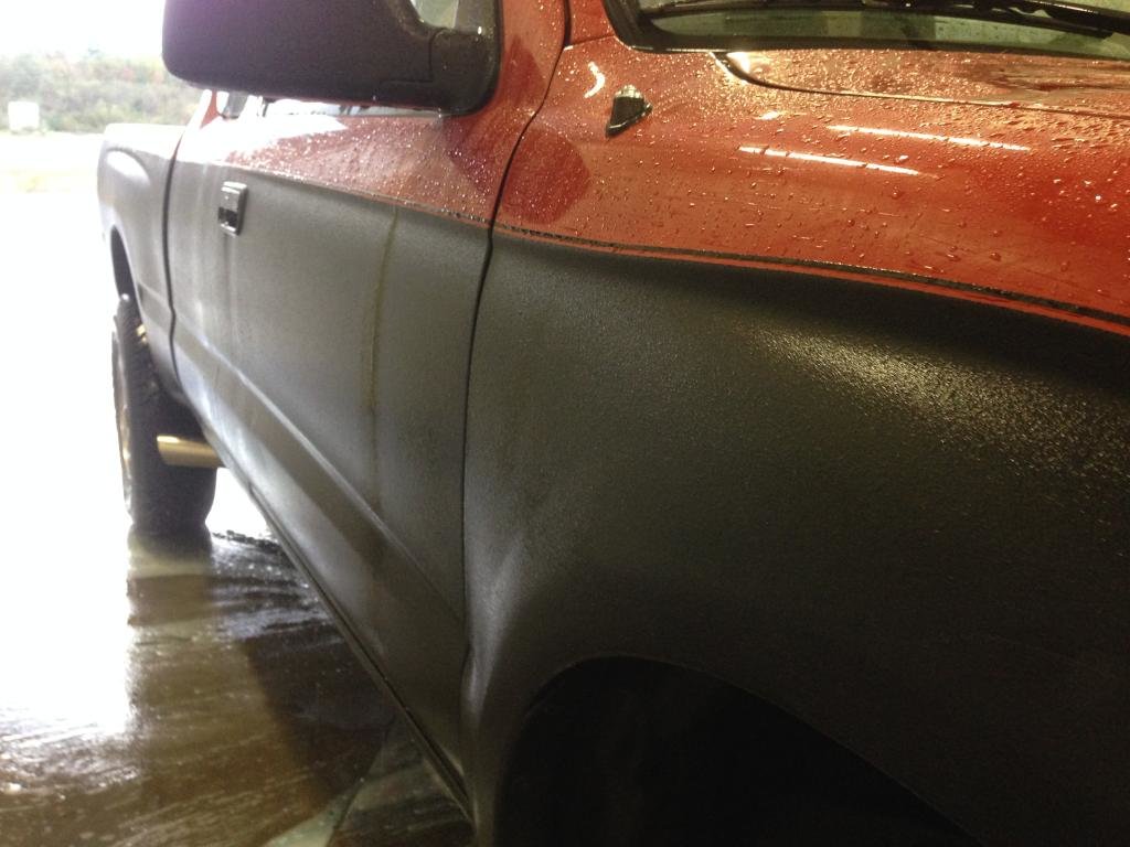

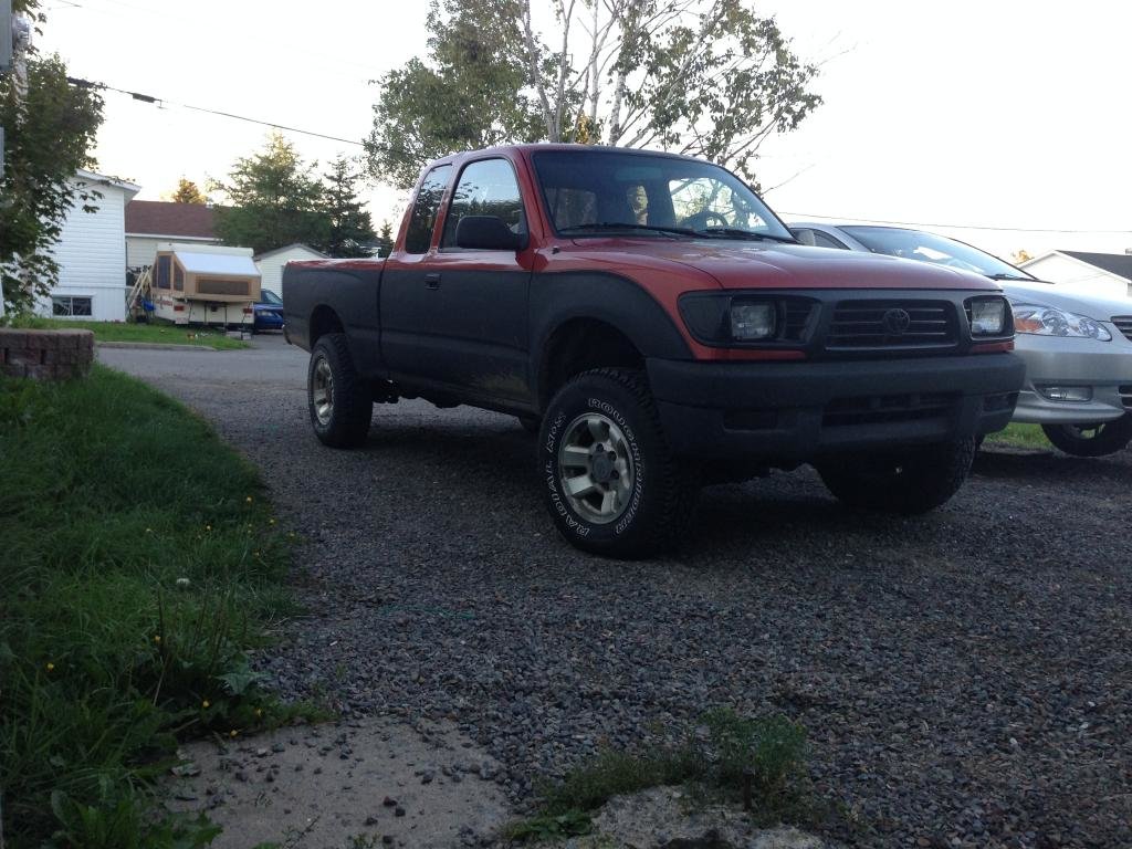

    I did my truck in bed liner up to the curve line of the fenders. Have you heard of plasti dipping yout whole truck?

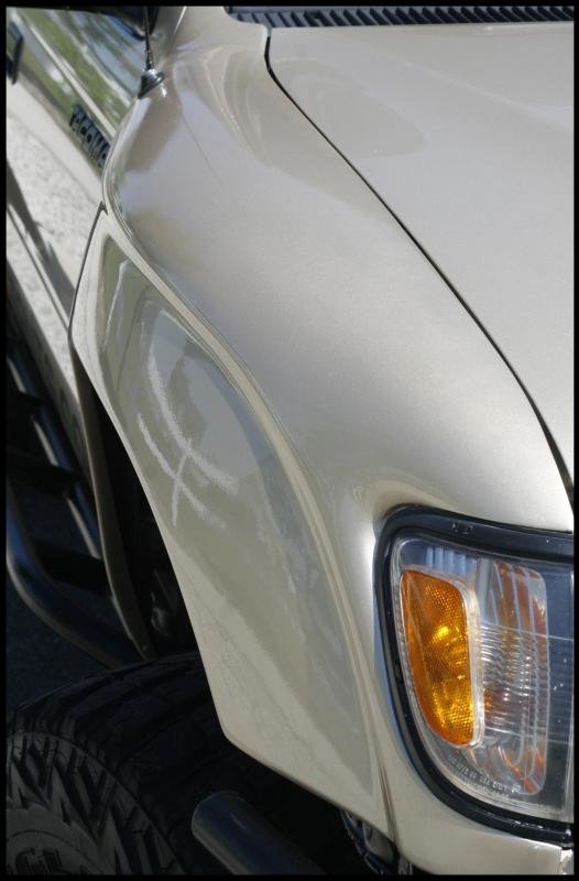

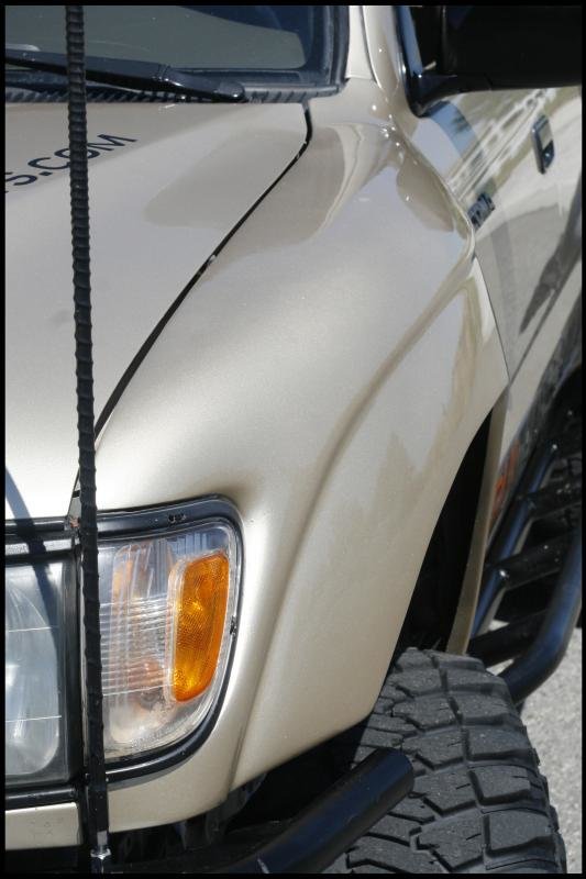

    As for rattle can paint, it can be done with decent results. I rattle canned my fiberglass fenders and they turned out ok. If you're trying to have it look "professional" then you'll want to spray with clearcoat over the top of the color. I had some color matched paint mixed into rattle cans on the local paint supply place and sprayed 3 coats of color followed by 7-8 coats of clear coat. All rattle can.

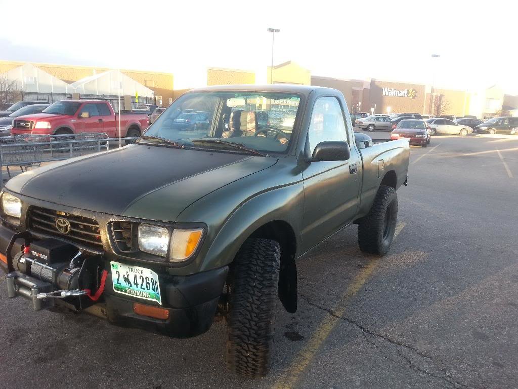

    This was rattle can, flat with a matte clear. The clear coat darkened it from the OD quite a bit.

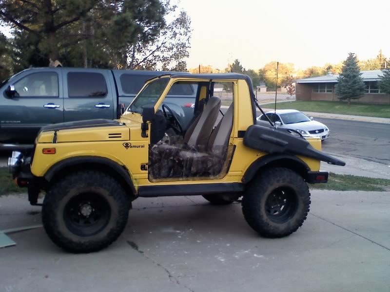

    This was rustoleum but spray gun instead of a can.

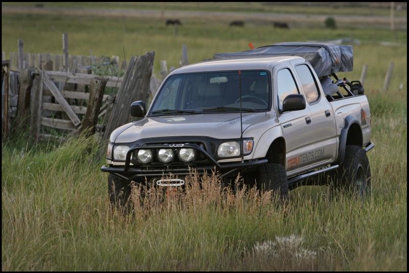

    Fresh paint
