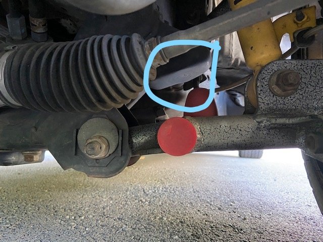

    Thanks for the help and replies. Hadn't thought to look at the front bump stops and you are right, there isn't much clearance, if I'm looking at the right thing (circled):
    I believe the measurement on the DJM one already on the kit is 1.75"; is it just a matter of replacing it with a shorter one? Is it possible to go too short?
    Also, I believe I was mistaken - the leafs may already be 4x4/Prerunner leafs as they have that familiar "floating end" second leaf (second pic). Can anyone confirm? The tops have been painted over so I can't readily see the part #.
    The bump stops at the rear are already shorter ones (about the size of an oreo cookie) so I'll have to do a bit more to get more clearance. Seems the easiest place to start is with the front bump stops and removing the blocks at the rear; this will give me the clearance I'm looking for in the short term to pass recon (an additional inspection we have required for modified vehicles) and give me a bit more time to think about a long term solution. What I'm leaning towards is replacing the control arms with stock ones and sort of starting from scratch, instead of starting with a 3" drop at the front and working around that.

    Yea I would go with lower profile bump stops in front . There is 2 shorter version . Look on bottom of this thread product discussed .
    You can go to short on bump stops . Need to know specs on your struts . Find compressed length and see its within limits. But seems you hitting bump stops for sure.
    When I lowered my prerunner was hitting bumpstop in front on bumps . Went with shorter ones and made a BIG difference in ride quality for me .
    I would start with just the shorter bump stops and see from there .
