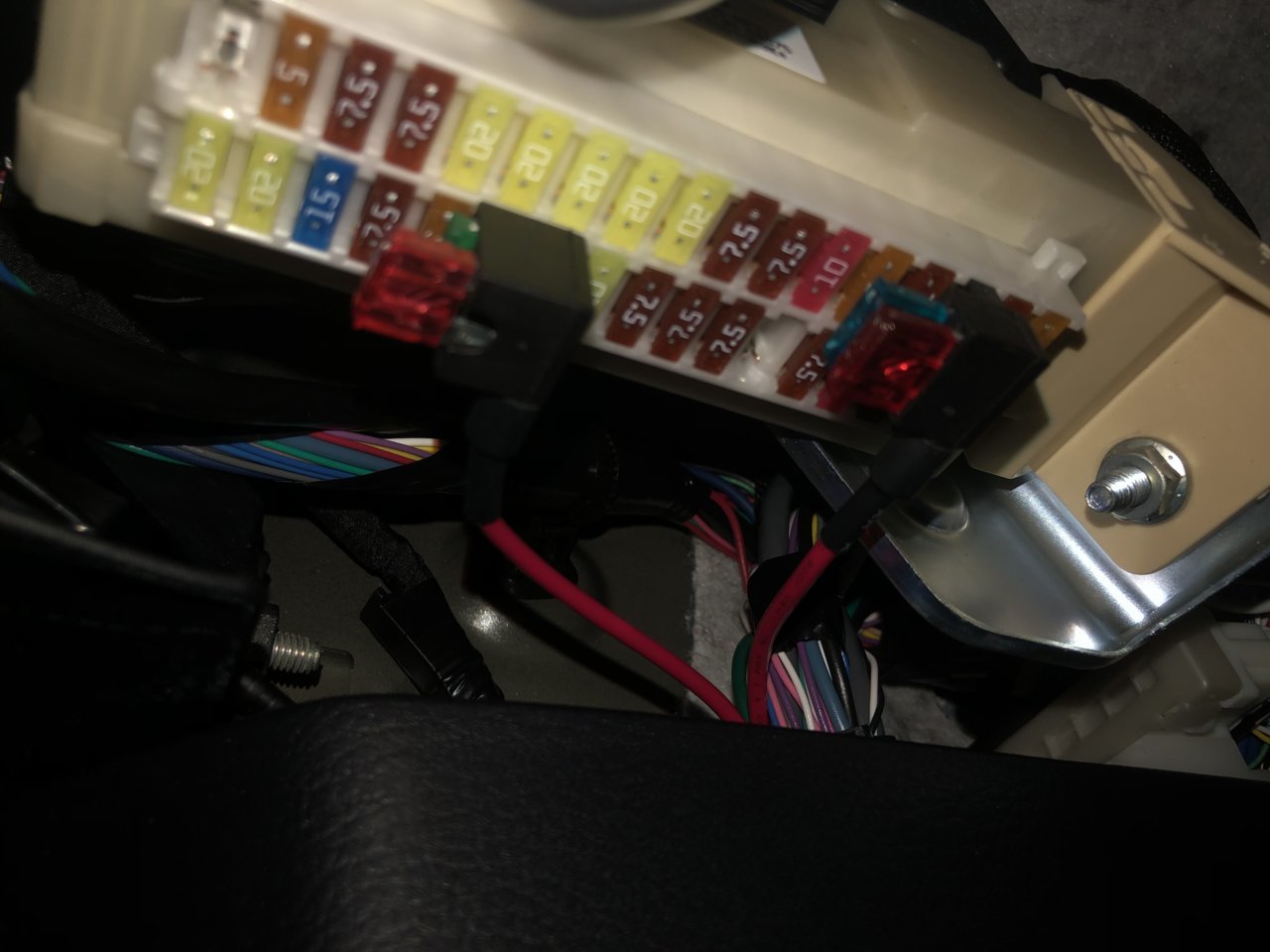

    Look at the fuse panel by the driver side kick panel and see if they used an add a fuse there. If they did, note what slot it is in.
    I used an add a fuse with a voltage cut off tapped into a constant power slot. The voltage cut off kit works great.

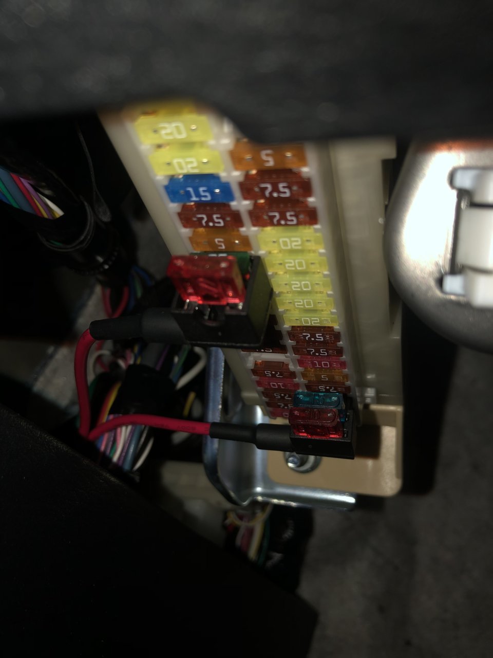

    I'll probably be taking it back to the shop tomorrow but here are a couple of pics of the fuse under the steering for those interested.

    I have the F800 Pro too on my '18. I installed it myself. The parking mode works flawlessly. The shop should have used the add a fuse on a fuse that can have voltage even when the engine is off. I can't remember which one I used, it was probably one of the fuses for the lights though (because those can be operated without the ignition on)
    They should have tested the fuses for "power" before just choosing the ignition fuse to use. I'm willing to be the ignition add a fuse is the issue.

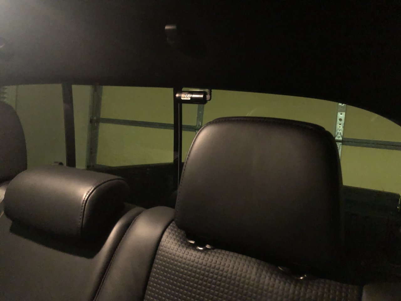

    Oh, since we're here...where did you guys install the rear camera? Mine's on the sliding window "hidden" (from my view) behind the middle headrest. I can still see the cable and it kind of bothers me lol. I toiled over the ideal location, but really haven't solved this issue. I also have a bedrack so I can't use the top portion of the window.

    Here is my rear camera.

    I cant remember which is which right now, but is it possible they just have the taps in the wrong order. Assuming both taps are for the camera, one for constant power and one for switch power, is that right? I dont have the same camera you have and mine just used one tap, but I have read others using two lines.

    Alright, for those that are interested, I think I got everything resolved here. I did take the truck to the shop that installed the cams and they at least understood that the system needed to be plugged up into a constant power source so the parked recording feature would work. However, to my frustration, they plugged both the battery cable (yellow) and acc (red) into constant power sources in the fuse panel. So the system basically stayed in continuous recording as if it were be driven even while off.
    So not wanting to deal with the shop anymore, I stopped off at Auto Zone on the way home from work, picked up a cheap fuse/circuit tester, and attempted this myself. I believe I got everything figured out after a little research and trial and error. I posted a pic of the fuse panel and circled each fuse I added into with the corresponding color. This setup seems to be working perfectly and is switching the system between continuous and parked recording as it should. I'd love to hear any suggestions if this setup should be changed. I'm no mechanic by any means and really shooting in the dark here. But at least I resolved what a mechanic shop failed to do :D
    Yellow Constant (Battery) --------> HAZ
    Red (ACC)--------------------------> IG1 NO.2
    I'm hesitant plugging into the IG1 but confirming that isn't a constant power source with my circuit tester and everything seems to be working fine, I'll leave it be unless anyone has a better suggestion.
    I also added a pic of where my rear camera is placed for the person asking previously in the thread.

    Hmmm...i'll have to see what I can find to make a bracket for the F800 Pro rear camera. I really like where yours is mounted!!
