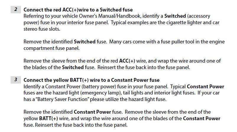

    DAMN!!!! I searched all over for something exactly like this to print off and take it to the shop that did the install. In all honesty, the shop did a great physical install as well as cable management. I met the guy who did it and he seemed pretty young. Maybe just a greenhorn and didn't understand this particular setup. Either way, wish I wasn't so hesitant on working on the truck and did this install myself. It wasn't near as difficult as I was making it out to be once I started troubleshooting the issue. I'm a network engineer by trade and hated the idea of damaging anything on this truck. Lesson learned :facepalm:

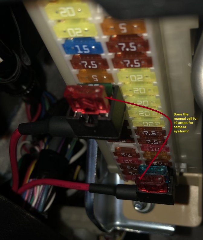

    Thanks, vicali. That's good to know! Luckily I park in my garage so the system shouldn't be triggered too often when i'm home. But when i'm parked at work or out for an evening will be a real test.
    In reply to Caribe, those are the fuses that came with the hardwire kit. The booklet that comes with the setup really doesn't explain anything other than basic use (powering on, hooking up rear cam, etc...) So I'm assuming those 10amp fuses are meant for the initial setup.

  6. Dec 11, 2019 at 9:36 AM
    #26
    ramrod84
    ramrod84 [OP] Well-Known Member
    Aug 10, 2012
    #84479
    78
    Little Rock, AR
    2020 Tacoma TRD Pro
    I saw that same video. I was really hesitant on some of the 10A and 7.5A fuses to patch into. I don't know if it's this way on all Tacomas, but I only have three 10A fuses to choose from and they all seemed pretty vital for the car and operation (4WD, A/BAG, IG1). There are more 7.5 fuses to choose from but even then, many of them had some specific importance to the truck that I didn't feel comfortable patching into. I think i'm going to leave things as they are now, but if I ever get to a point where i'm having issues, I might try some of the 7.5amp lighting fuses like the DOME or BKUP LP ones. But even then, those have every day use on the truck vs the two fuses I chose that are rarely ever used.

    I meant the fuse to the camera system. The ones you are tapping into are fine...

    Oh I gotcha. Yeah those were just some that came with the hardwire kit so I never even considered using anything different.

    Also, wouldn't one of those add a fuses be backwards? A lot of people don't know they have a proper orientation.

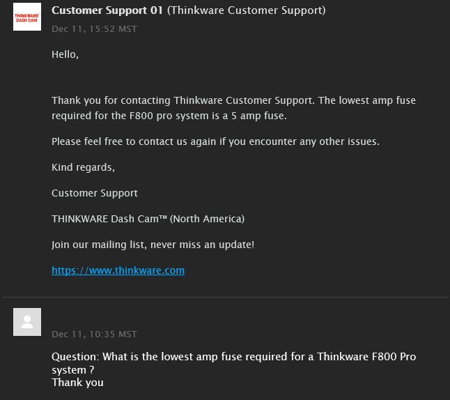

    Look what CS answered:
