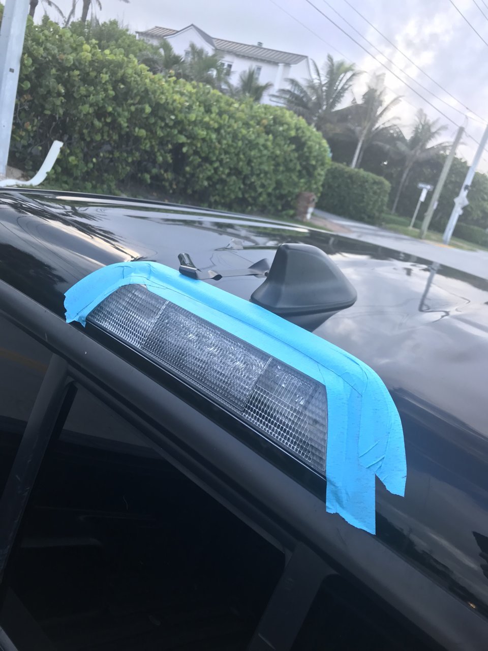

    Forgot to upload the picture of what Toyota said was a “temporary fix” they said there were 6 total currently on back order from the factory out of California hoping it comes before we get anymore rain.

    That's what I did on my own while waiting for the part to come in due to forecasted thunderstorms, it does work.
    Why do you have a strip of electrical tape on the roof?

    I had brought it in taped up with black electrical tape prior to them messing with it. They just took it off and through it on the roof

    I used the blue painters tape to prevent residue, its really not as noticeable since the light is high up.
