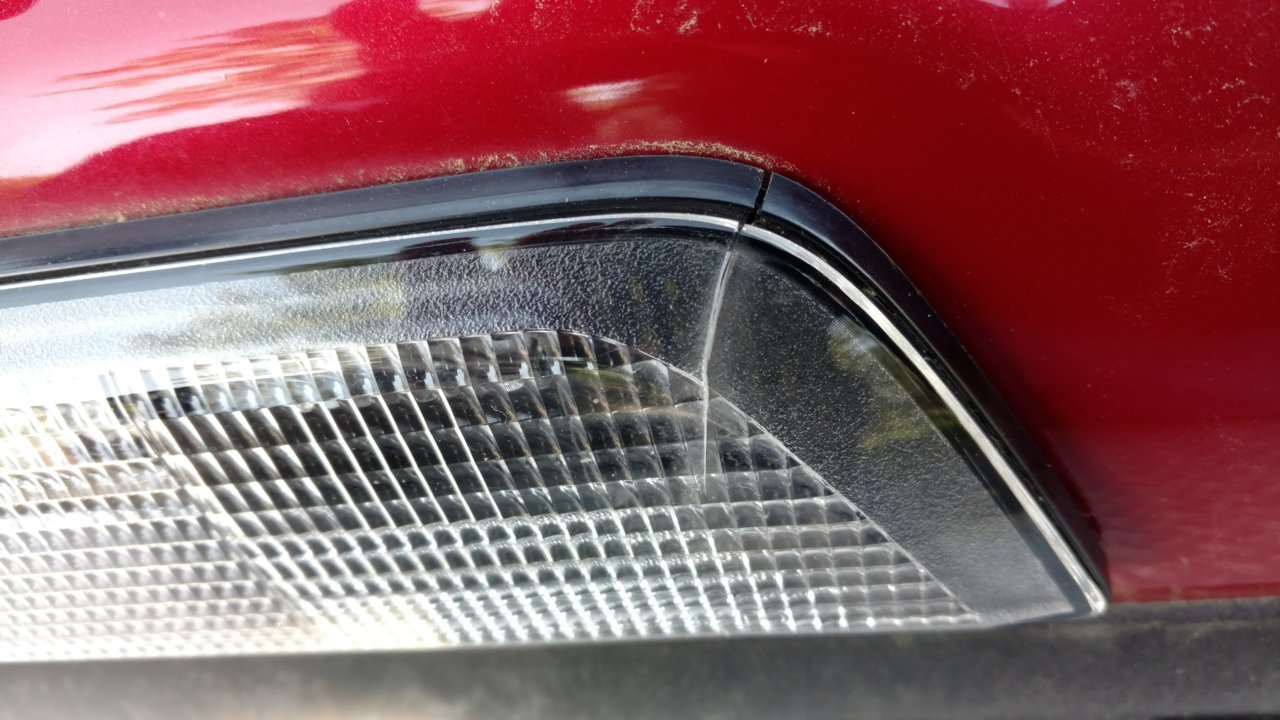

    2016 dbl OR tacoma
    I have the exact same crack that was followed by the leak. Dealership says it’s out of warranty and they are not responsible for the repairs. Left with water damage to seats, carpet, headliner, and sound insulation.

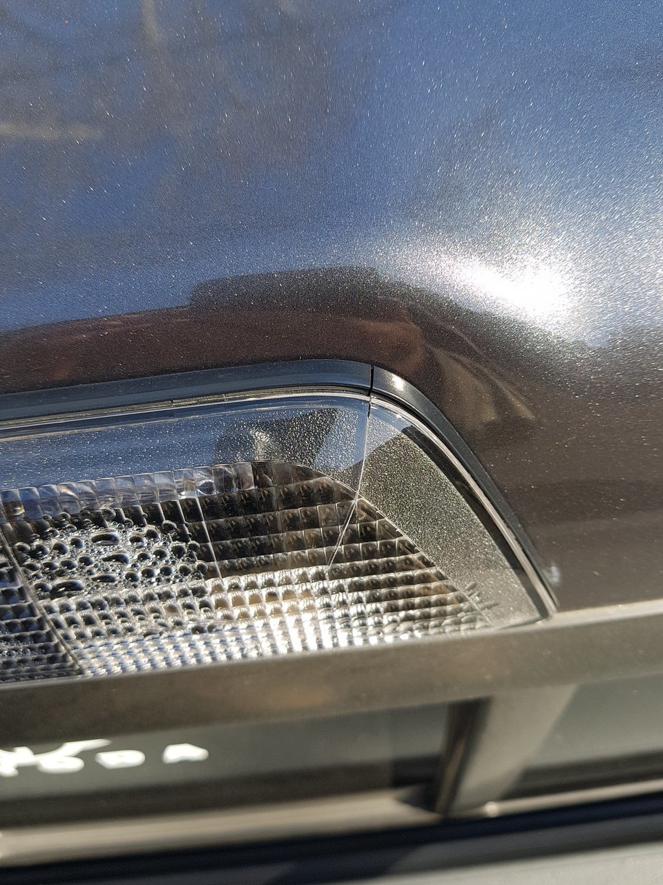

    Reviving this thread....2016 TRD Sport DCSB with 60k miles and just noticed the leak....very disturbed...
    Also just got the frame corrosion letter from Toyota so went into my local dealer to get the brief...
    Service manager told me my truck can be given a protective undercoat spray starting next year (two year window to have it done)
    As for the leaking brake light...he printed the TSB for me, gave me Toyota's 1800 number, and said good luck...said a 16 Tacoma just got repaired under warranty for this recently...
