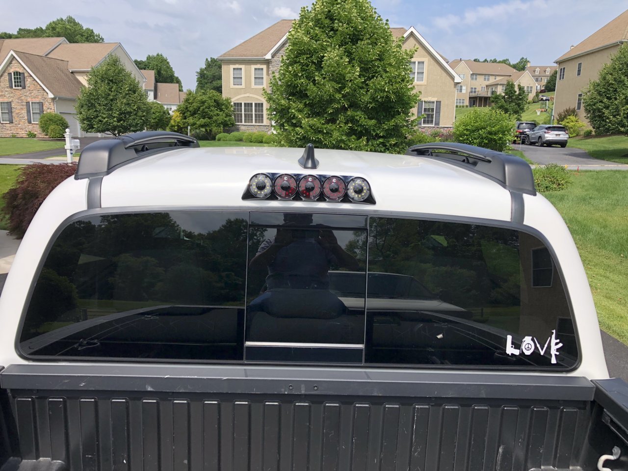

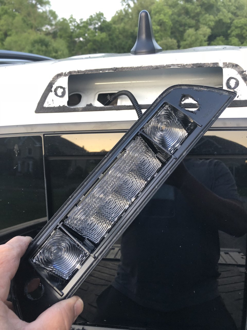

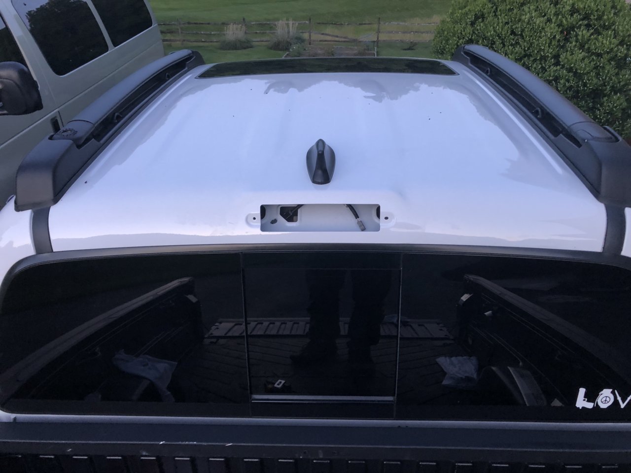

    Drill the oem one out and install an aftermarket one from MESO
