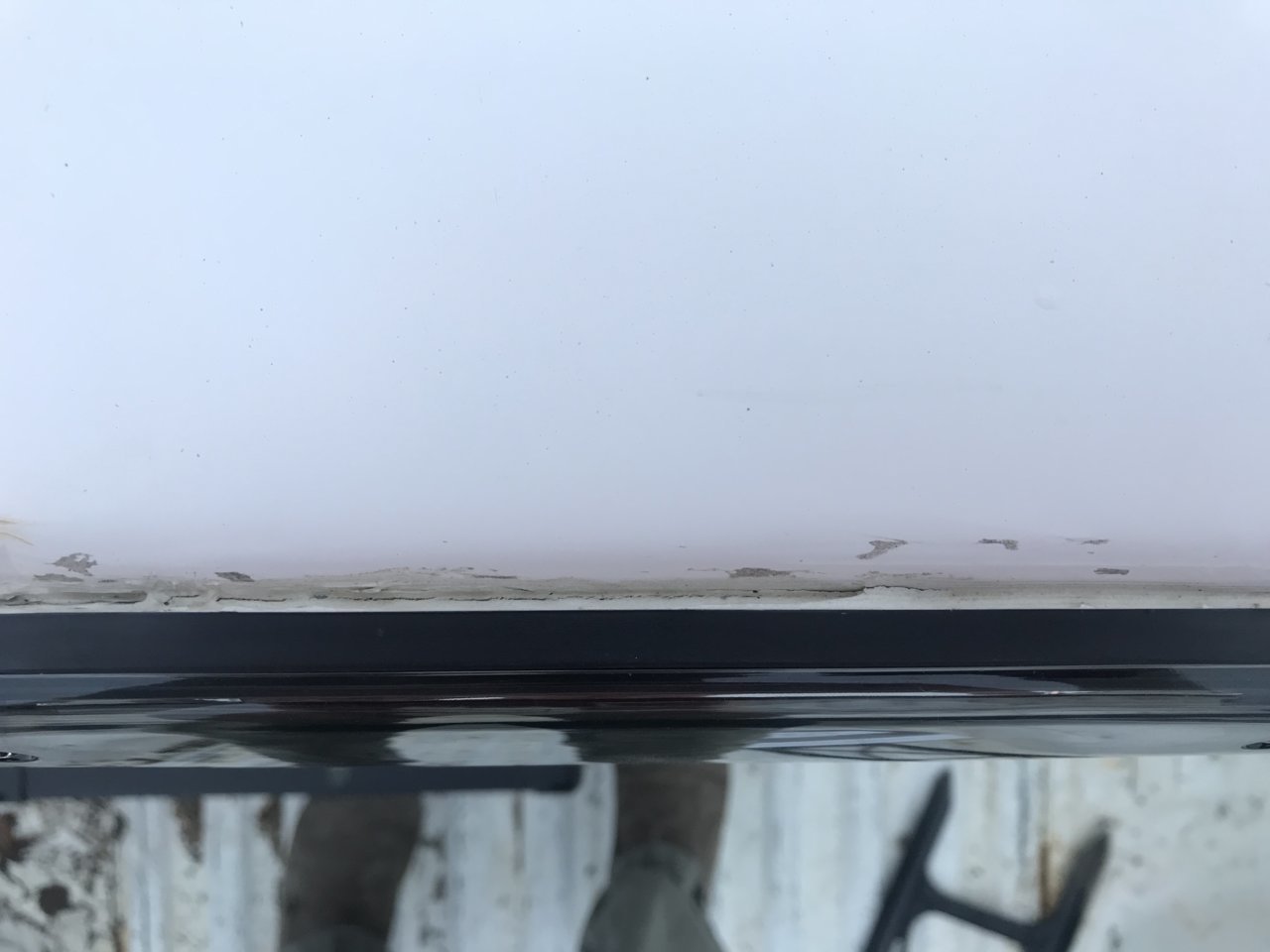

    Yeah, I did mine without even having to go inside of my cab. Basically removing it’s simple, you take off the two bolts holding on the 3rd brake light then they’re ls gonna be some mounting tape holding it on as well. As far as that goes I just used fishing line to get behind it and a razor and it worked fine. You probably one be able to save your oem brake light when you remove it unless you get new mounting tape on the back. The new light should come with mounting tape and so fourth, and once you get your old one off, you plug the harness into the new one, remove the backing on the mounting tape and basically just stick it on. But before you do this make sure you have the toggle anchors on your screws and you can just screw it in once you stick it. Also make sure to clean the area where the old brake light was with some alcohol or something because it’ll help the new one stick better.
    here’s some pictures of how mine turned out,
    the grey stuff on the surrounding parts of my light is just glue residue I didn’t remove when I did it, and also I used some caulk on the top so I could seal out any water that may come in in case.
    goodluck I’m here if you need anything else
