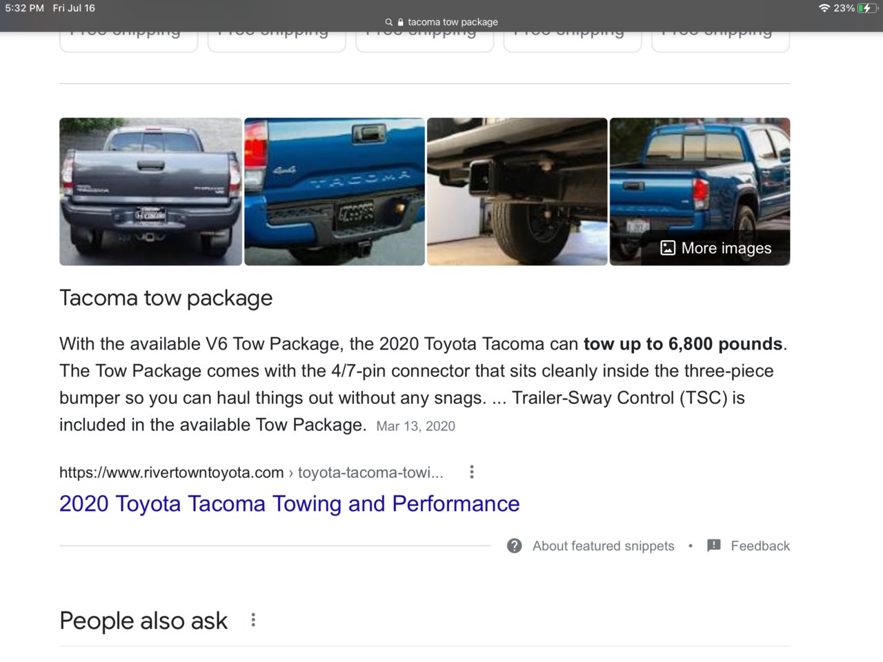

    I tow 4k lbs about three to four times a year and just want to be prepared.. this is why i’m asking (refer to pic)

    I believe all v6 engine Tacoma's have a tow package. It was standard on my 2020 SR5 V6. It doesn't include the electric brake controller but it's pre wired for you to get one and plug it in. You will need the correct size ball for your trailer. 1-7/8" or 2" is what most trailers you will tow with a Tacoma will use.

    v6 comes with tow package

    Note that the specs say "UP TO" 6,800 lbs. Each trim level has slightly different maximums.
    I suspect it is based on Maximum Combined Gross Vehicle Weight.
