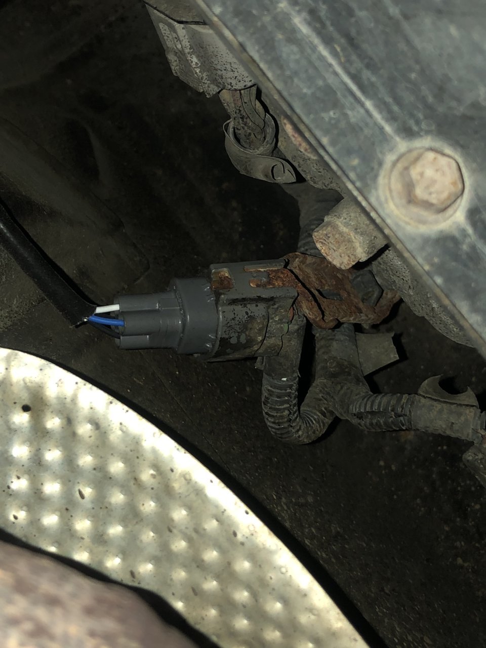

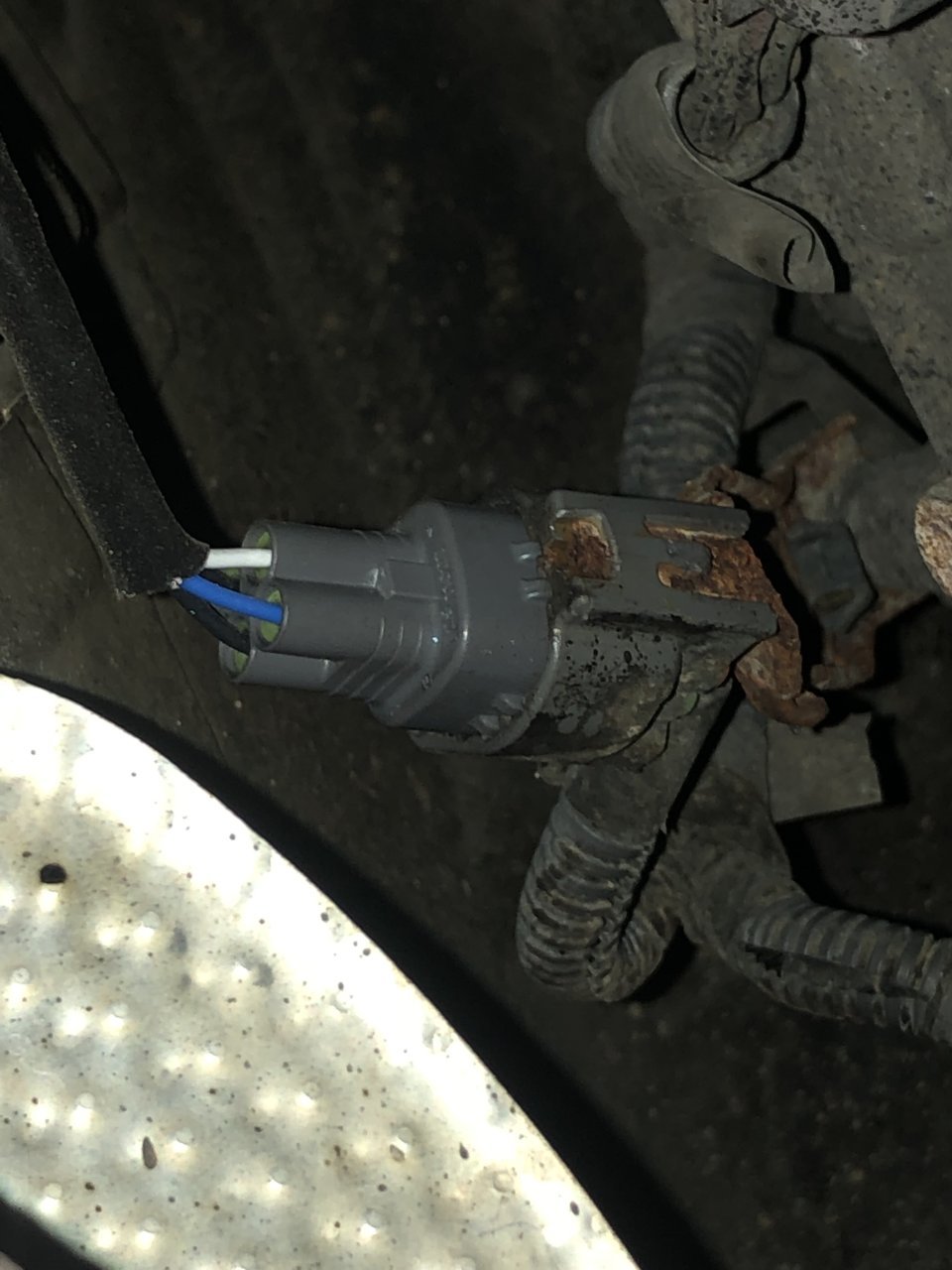

    Based on the symptoms, a corroded connection in the harness somewhere seems likely.

    If B1S2 keeps triggering its usually the upstream a/f sensor giving wrong readings.
    It's complicated but its common on Toyotas. Harnesses or wiring is not common, but a possibility.
    If you have the freeze frame of the error share the voltage of b1s1 and b1s2.
    It's 100% not b1s2 thats established.

    I don’t have the right reader to get the voltage
    I don’t have the right reader to be able to see the voltages. I took these pictures of the harness.
