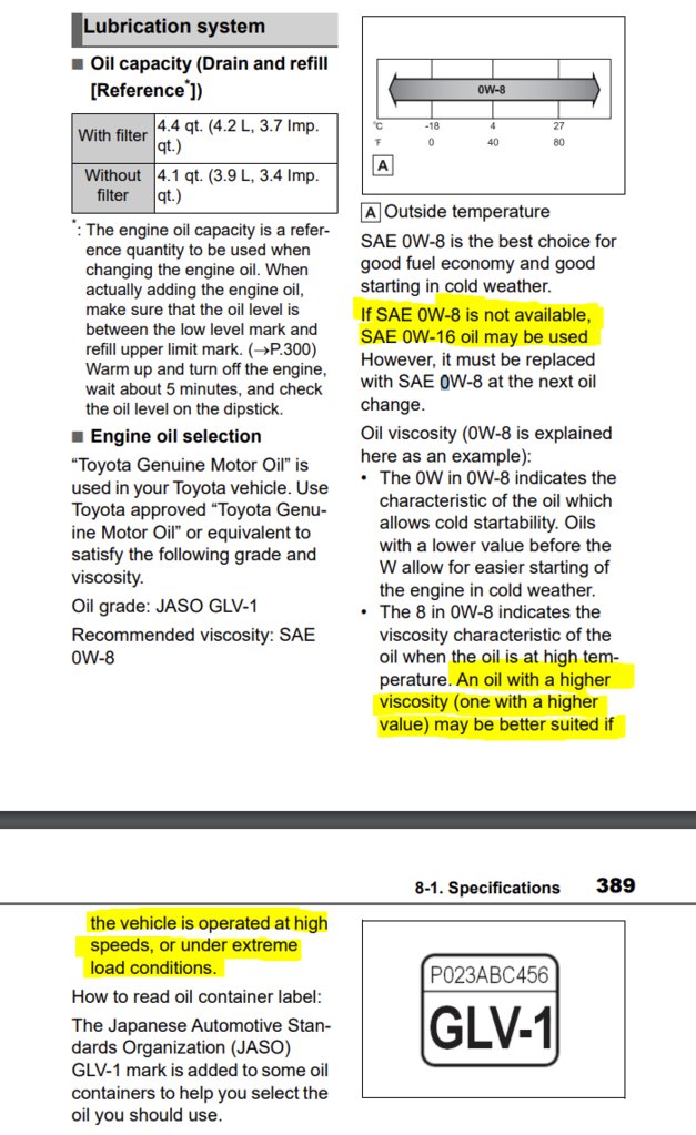

    Couple highlights from the manual I thought would be worth pointing out. The 0w8 specification comes purely from a fuel economy standpoint, you're not going to nuke your ringlands into orbit with 0w16, Toyota even recommends it for extreme driving conditions.. All in that oil isn't as dark as the black hole flor-ida crawled out of. :evil:
    Curious to see your blackstone results though. I have seen values pushing 5% fuel on these newer hybrids. Tell your mom to hammer it every now and then..
    https://www.sae.org/publications/technical-papers/content/2020-01-1426/
