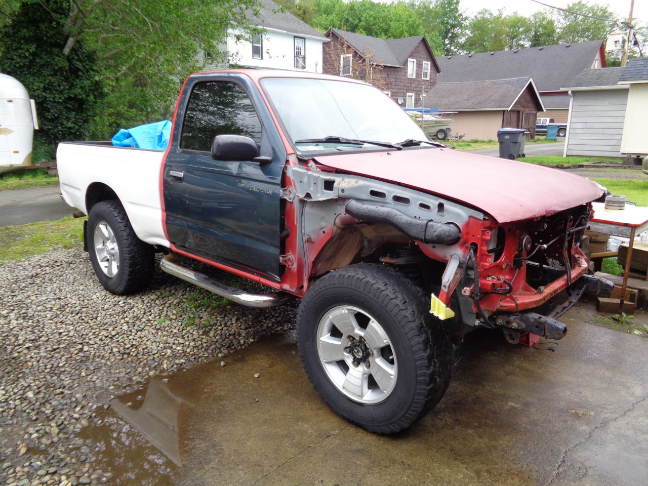

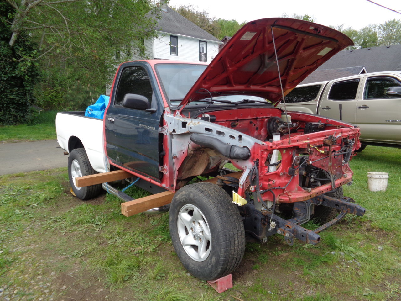

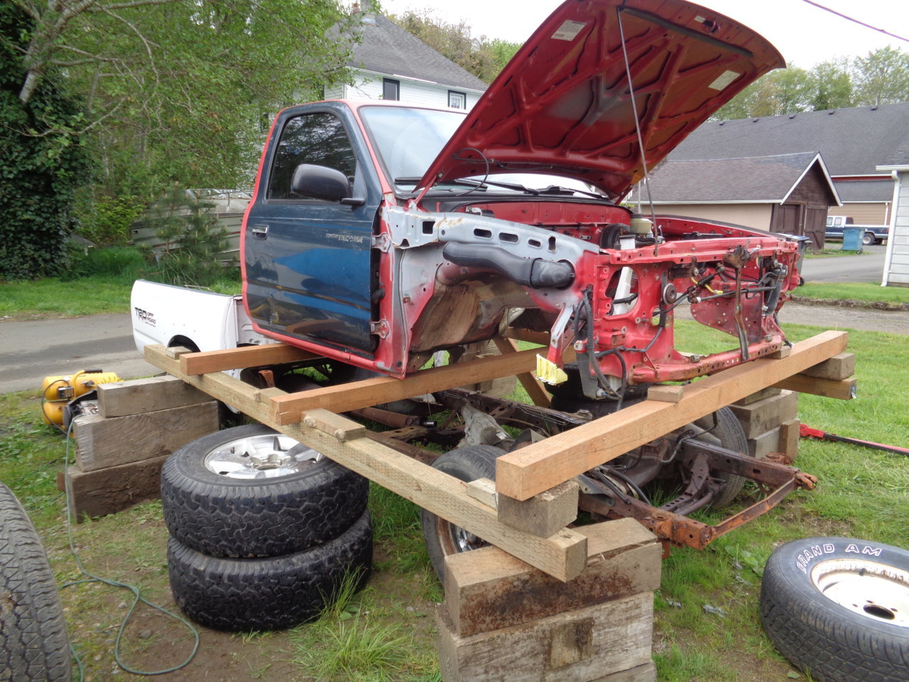

    Well moving forward. Today I jacked up the 2x4 cab.
    DSC00924.jpg I pulled out the 2x4 frame with a tow strap.DSC00929.jpg rolled the 4x4 frame under.
    DSC00932.jpg and lowered it back down.DSC00937.jpgIt almost looks like a truck again. I still have the 4.0 but it needs a special oil pan or the truck needs a strait axle that I do not yet have. I have recently reacquired the original engine not that it even left my possession. It would be really simple to make it run with the 4 banger.

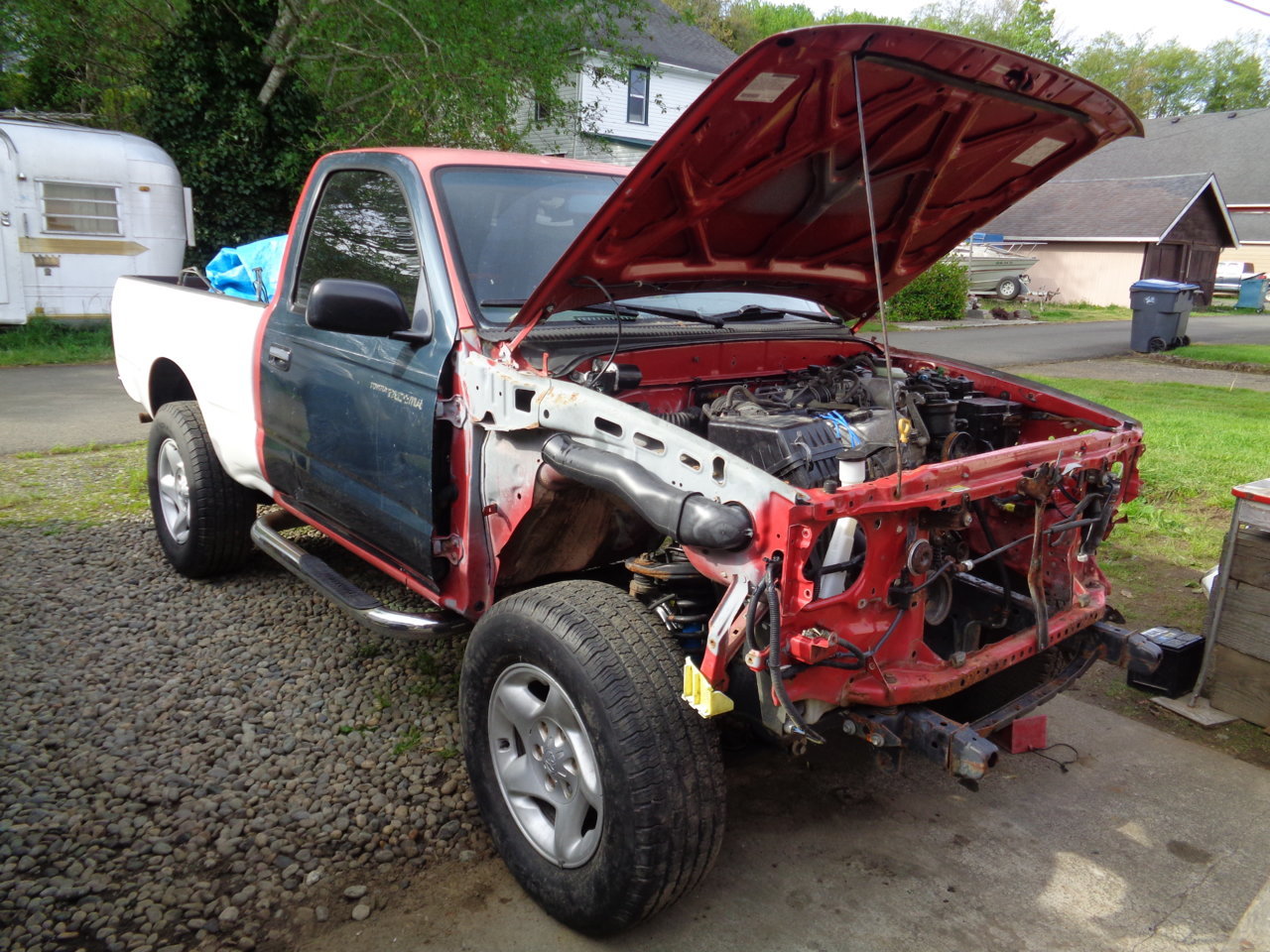

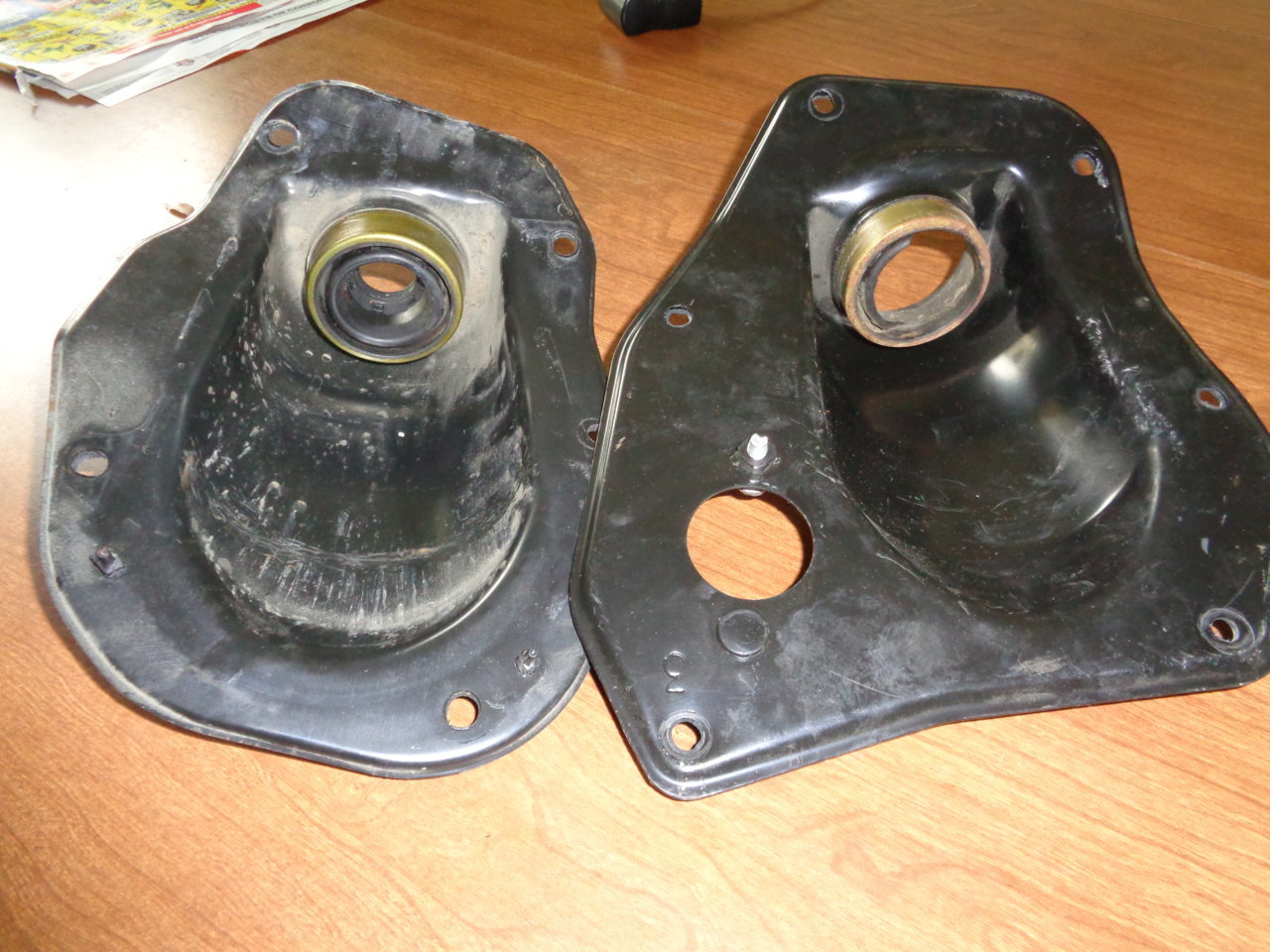

    Today I installed the brake booster, steering shaft, the struts, and set the 2.7 engine in.
    The little rubber that the steering shaft goes through at the firewall was worn out. I was able to use the one from the 2006 tundra. They were the same. Here is a photo of them already swapped out.
    DSC00942.jpgHere is the 2.7 right back were it was to begin with. DSC00943.jpg Almost looks like a truck again. Too bad I didn't have a blue door. I could put stars and stripes on it and fly it around.DSC00944.jpg

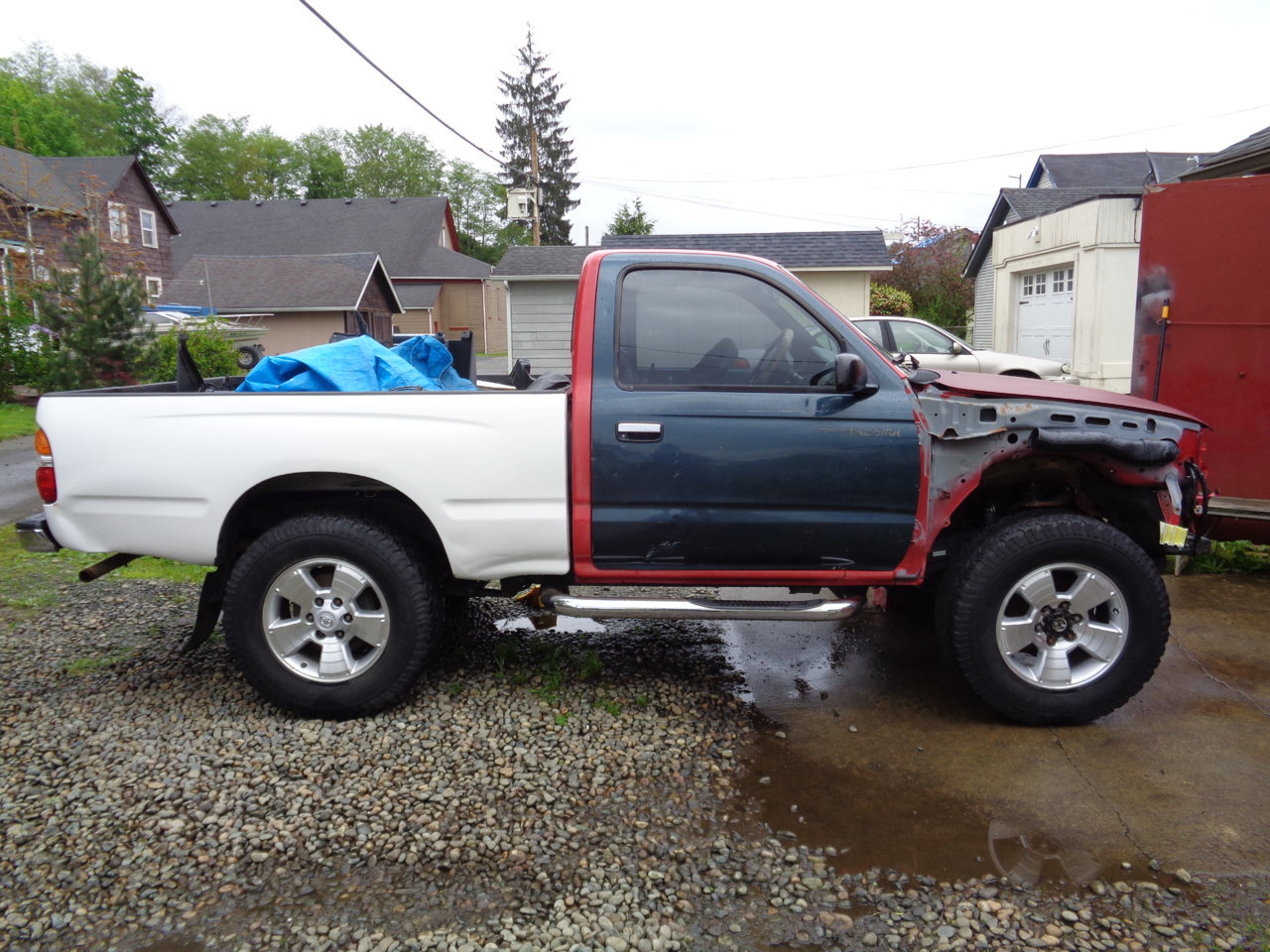

    I sold the wheels! had to go to another set of bald rollers. They happen to be the same shoes I brought it home in. Seems like I tear this thing apart a lot. I took the manual hubs off of it 2xs for prerunner conversions and now I am going to steel this set to put on my 2nd gen. That means I will have to put auto hubs on it.

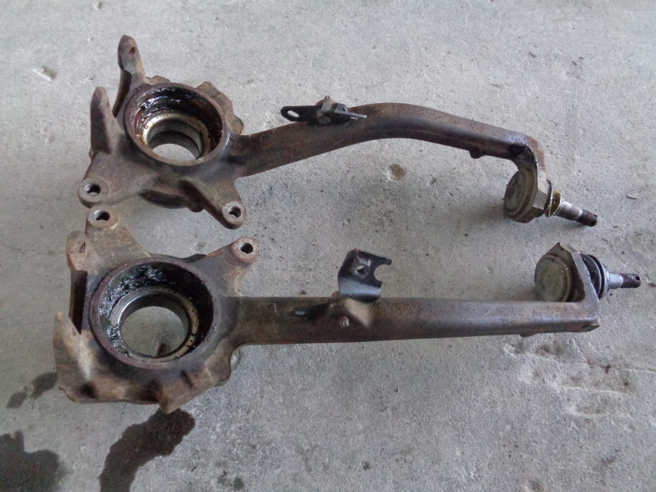

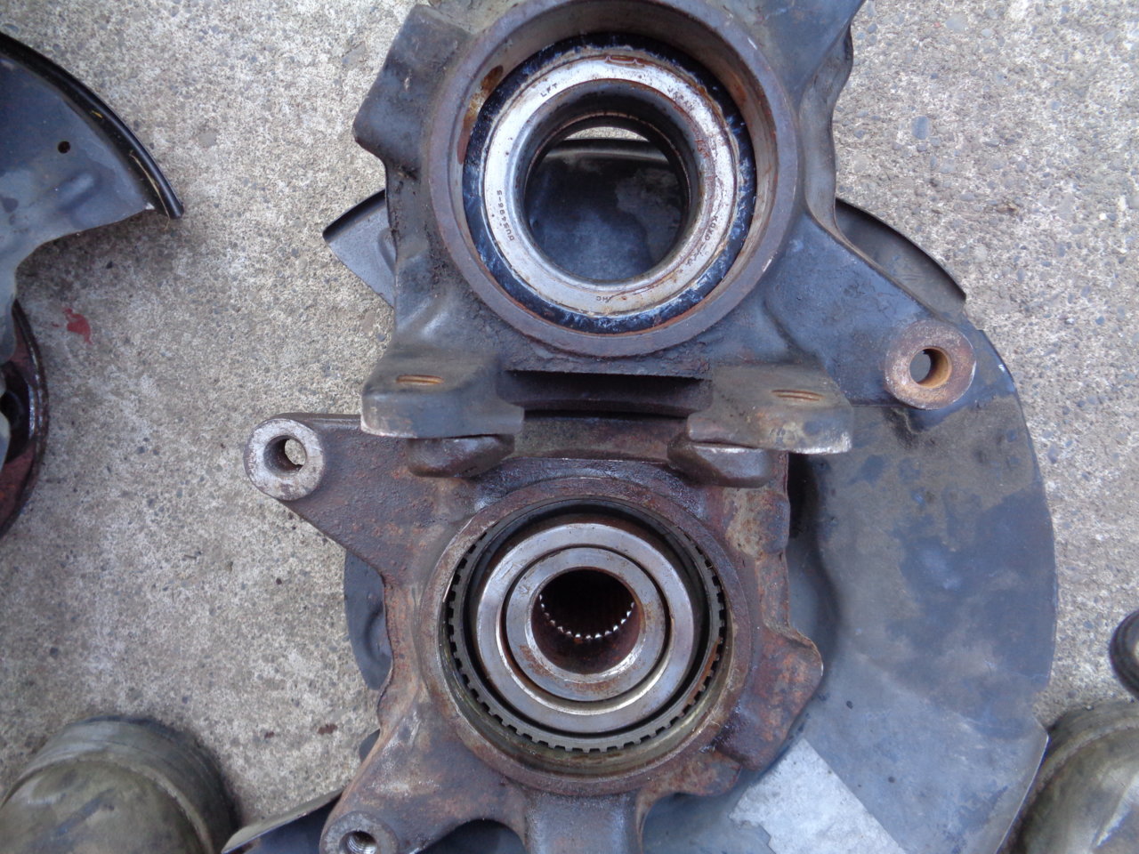

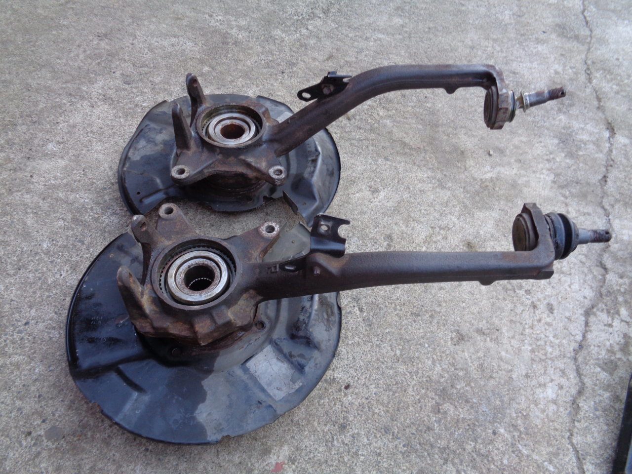

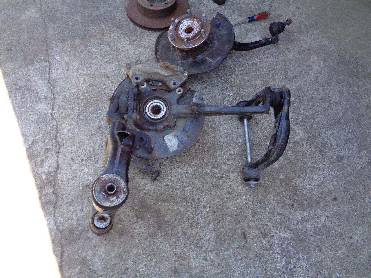

    I am working on disassembling the steer knuckles from a 4x4 swap. They already have the hubs pressed out. I took the 06 tundra steer knuckles out of the parts house. They are almost the same as the taco. The lower ball joint bolts are larger on the tundra and also machined a little wider. Here they are.

    The stud on the upper ball joint of the tundra is a larger diameter also. I did try to use them to make a half ass roller of it before I got the 3rd set of lockout steer knuckles. I did not work.

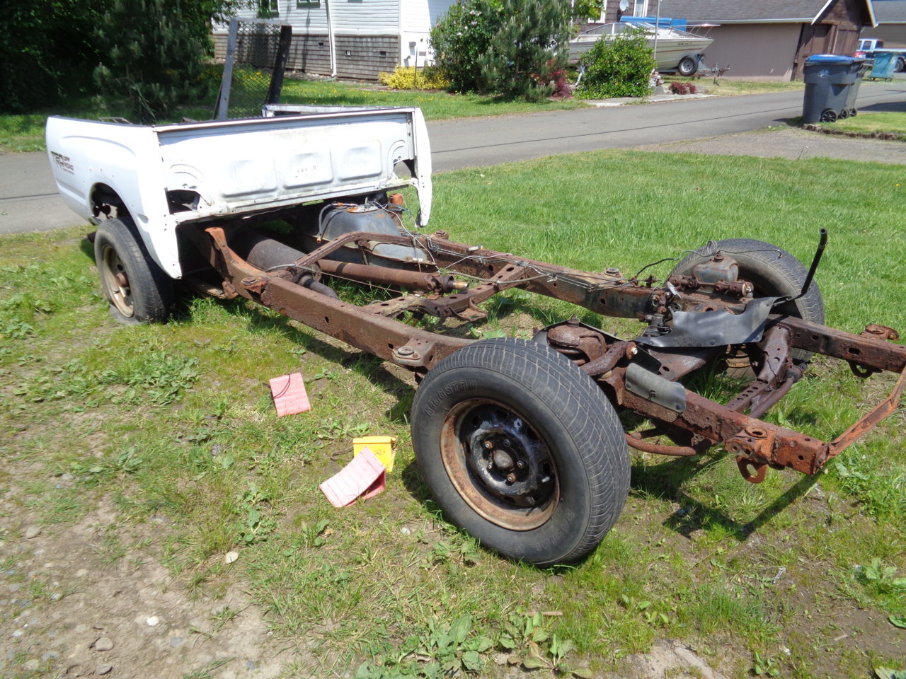

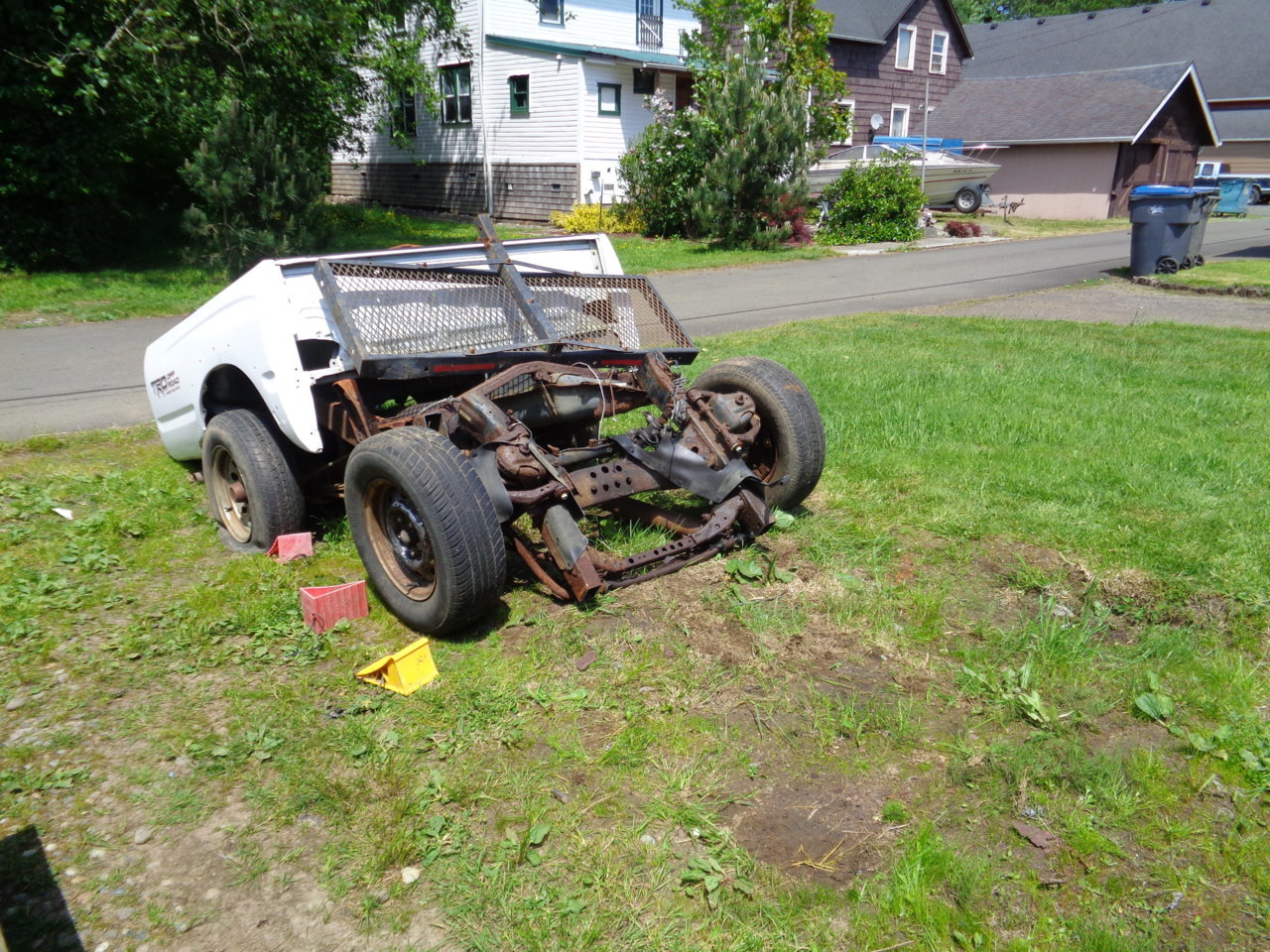

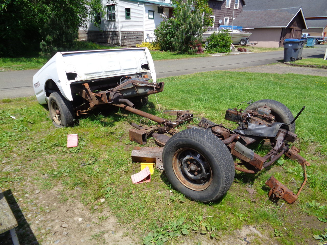

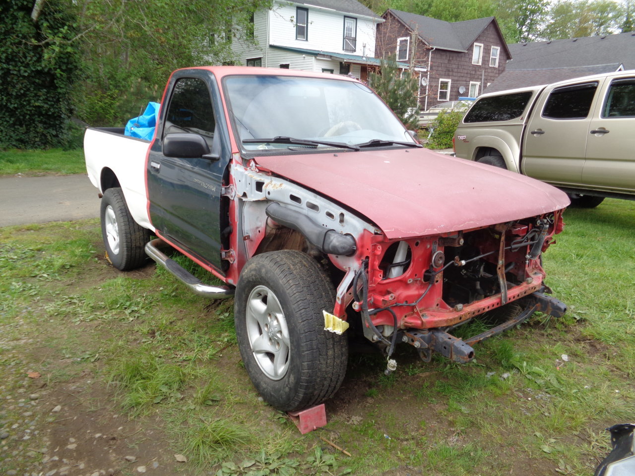

    The 2x4 frame was rusting up good, so It had to go. It is not really gone yet. It did transform into a smaller pile.

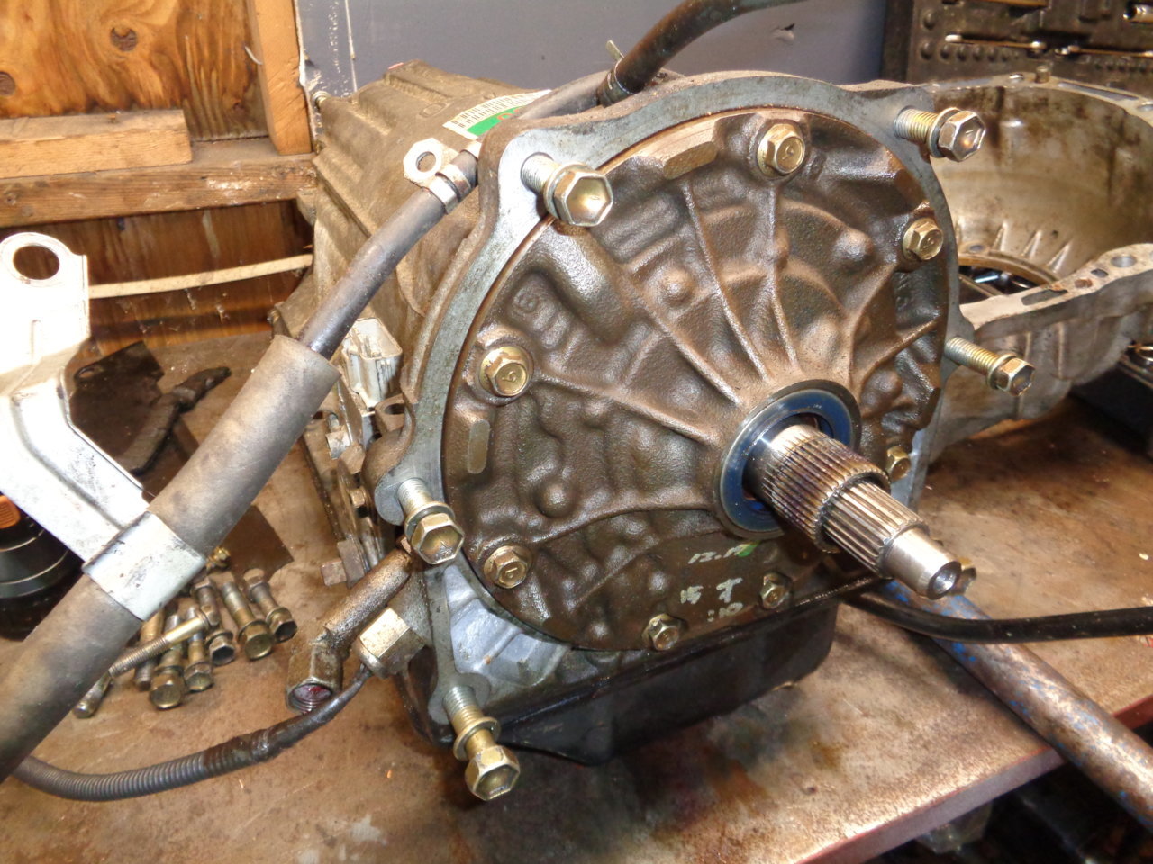

    DSC01005.jpg DSC01006.jpg DSC01007.jpg I got a little lost in the transmissions. I had swapped the bell housing and pan onto a t 100 trans. I was going to use it, but the output shaft is a different length. Here is the original trans with the correct shaft.

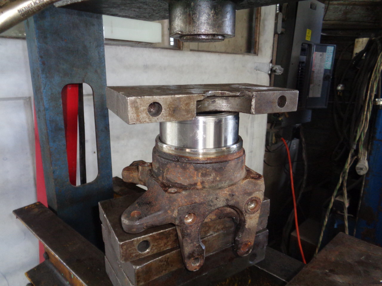

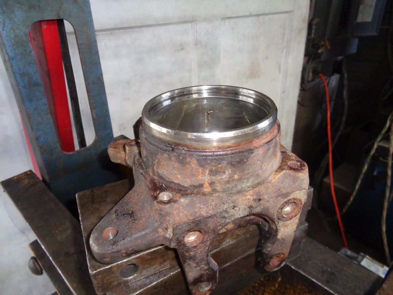

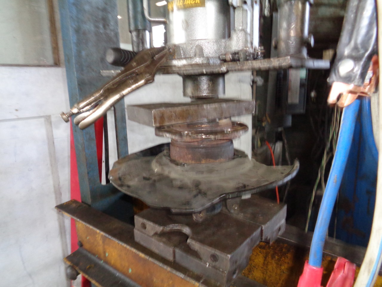

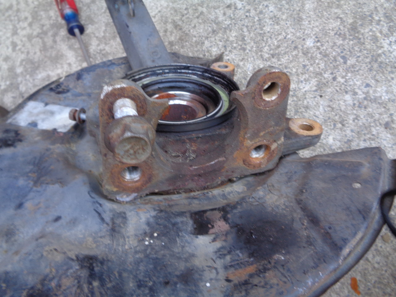

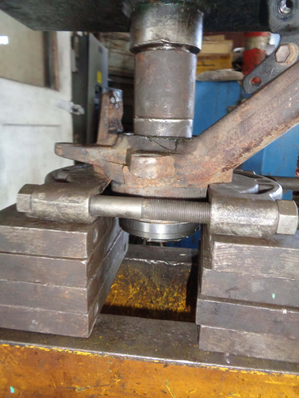

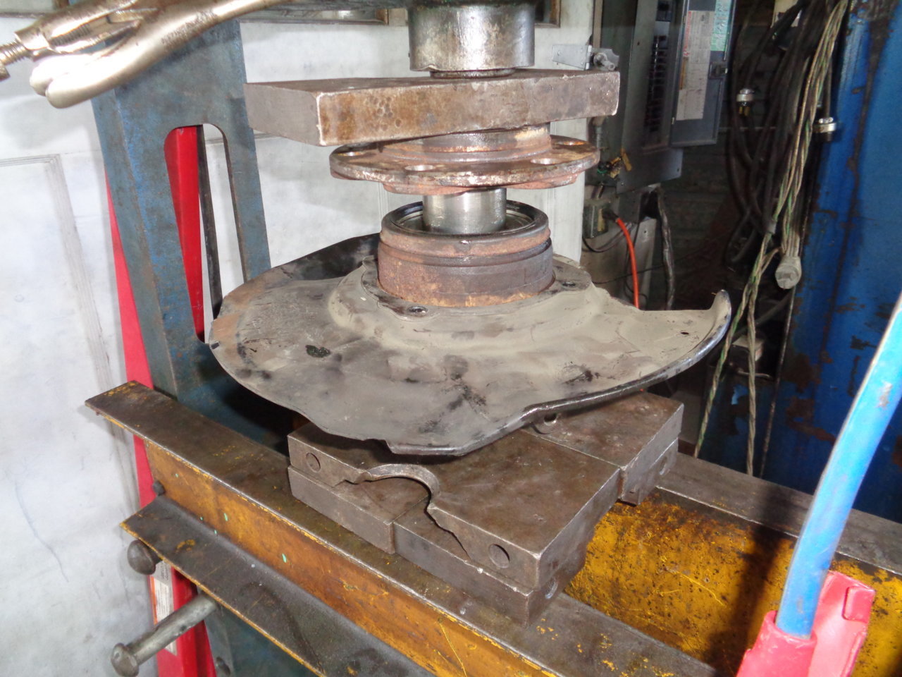

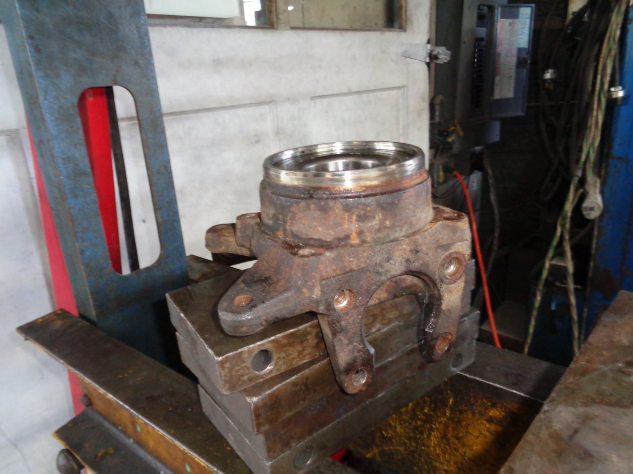

    Well today was a good day. I have had paid to have press work done to replace 6 front wheel bearings before now. (NO MORE), I say. I have successfully completed the job my self. With the help of a an old friend, use of his 20 ton shop press with plates made the work possible.

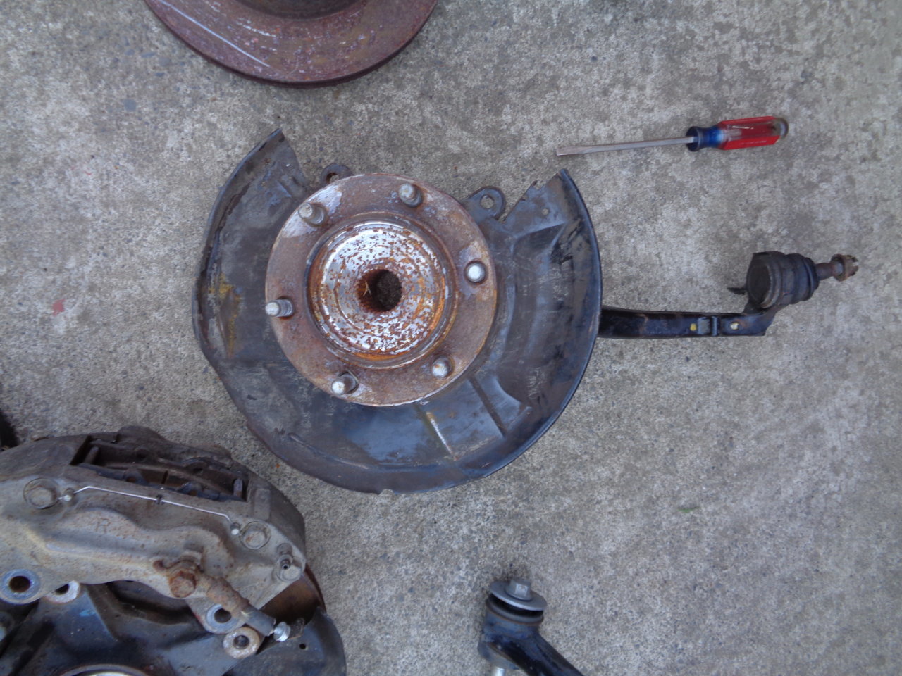

    These are the steer knuckles without abs I used. Before I worked on these I pressed out the hubs on the 06 tundra steer knuckles.
    DSC01014.jpg First I had to press out the old bearing. It took longer for set up. Trying to figure out what to use took some time. Once I got it in there square, it was easy. DSC01015.jpg Below is the giant bearing separator that made it all possible. If I had one, I may have gotten farther at home. I do not really know why, but I did use a tape measure to be sure the bearing separator was square.DSC01016.jpgI did not spend too much time cleaning or prep work on the knuckle. Wiped it out and gave it a little lube and went for it. DSC01021.jpgI just used the plates that were available. Look scary, I know. It went strait down. Some jarring sounds came from it. When I got the bearing flush, I used the old bearing to inset the new bearing into the knuckle.DSC01022.jpgIt was not bad at all went right in. I snap ring c clip fit in and then I put on the dust seal. DSC01023.jpgI had to run home and get the backing plates. I almost forgot to put the backing plate on the second one. I also almost forgot to support the bearing at the race. Both of these were reminded to me as my old friend just happened to walk by on separate occurrences. Just my luck, I was saved from ruining the bearings. I really could not believe how his timing saved it. DSC01024.jpgIts all in. Then I had to flip it back over and install the tone ring and retainer. I did not want to dig up the spacer that replaces the tone ring on non-ABS models. DSC01025.jpgYou may not see this often (bellow) abs tone ring and not machined for the abs sensor, LOL DSC01029.jpgHere they are. I still have a bit to do to prep them. The hard work is done. The next photo is the 06 tundra knuckles next to the 99 taco knuckles showing difference in lower ball joint mounting service. DSC01026.jpg
