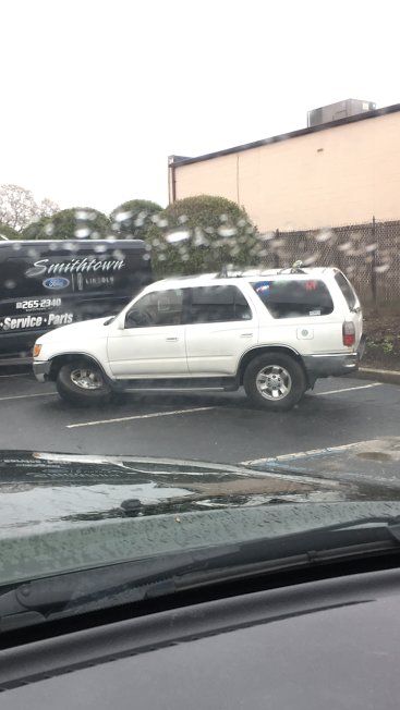

    catastrophic ball joint failure is imminent
    ask me how I now...
    lady said "yea I know I have been ignoring the weird sounds for a real long time"
    preventative maintenance goes a long way
