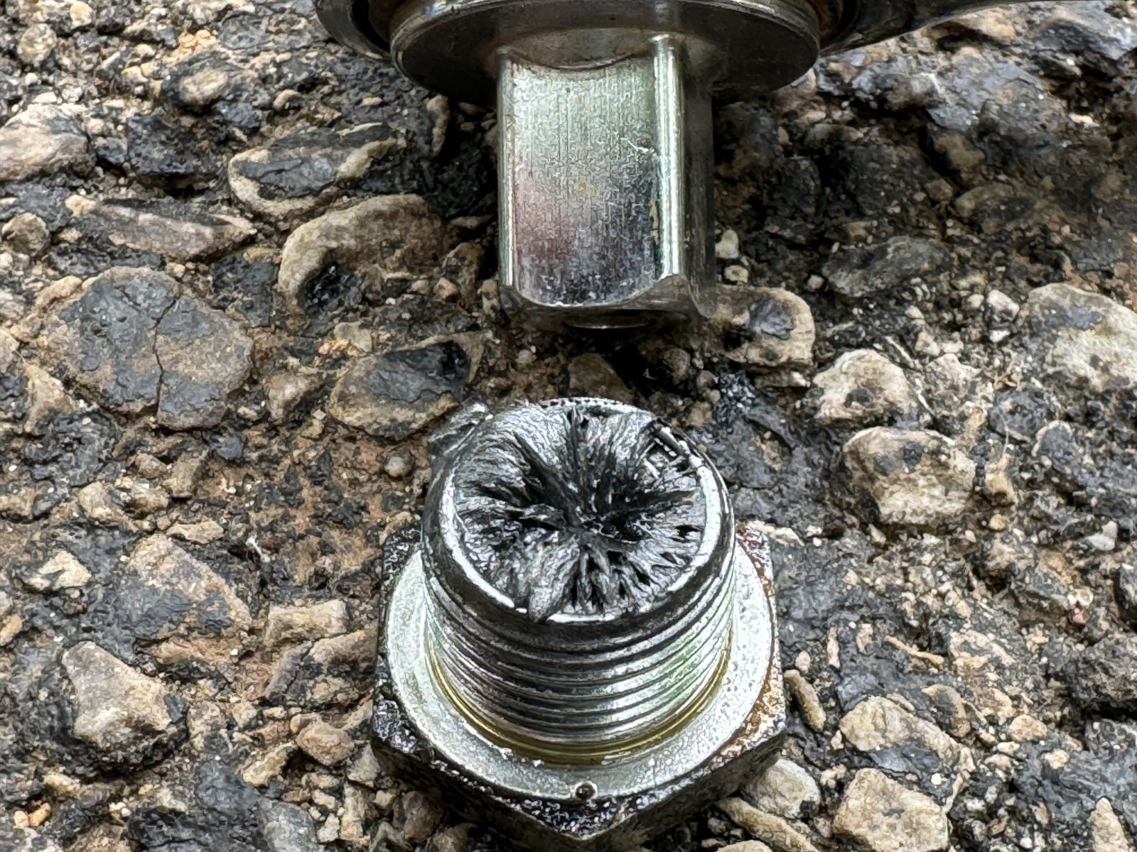

    Need some perspective from experienced peeps.
    2015, 6 speed manual. No idea if this is the first or second transmission oil change. 89k miles. That looks a little heavy to me, but I do not have a frame of reference.
    1/2” socket drive for reference.

    Looks normal to me. If you see larger chunks, then that would be bad.

    looks very normal.

    Looks normal to me. Rear diff drain plug will look similar.

    We always called that stuff swaif, semi metallic ferrous sludge that's associated with a gear train being used.

    Yep, normal for a (assumed) first change. It'll get better every time. I'm at 162,000 miles and have changed mine 3 or 4 times. I pretty much don't have anything on the plug anymore.
    The first time, mine looked similar to that.

    Cool; that is a load off of my mind. I was worried that the original owner had abused the crap out of the tranny.

    no chunks no worries.

    That is some what normal. But can also be a sign of a worn transmission mount.
    I honestly think you have nothing to worry about.
    Also, the metal debris on the drain plug are 100% normal. You are all good. No worries there.
