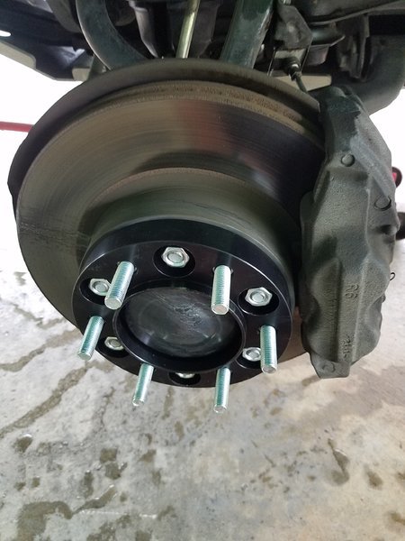

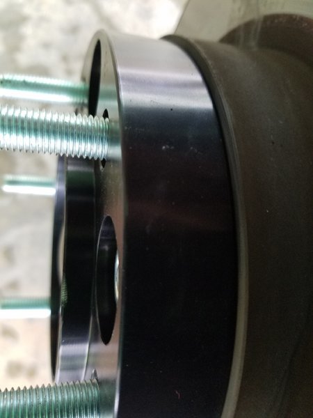

    I just installed 1" spacers on my 2014. With a 3/4" spacer you will need to trim @ 1/8" off the factory wheel studs to fit the factory steel wheels. This is why I went with the 1" spacer so I wouldn't have to modify anything. 20160914_110655.jpg 20160914_110703.jpg

    Aloha from Oregon \m/ How's da studs on da Bora's tho? Looks really long in da pix. No need trim em lil bit? I feel like my lug nuts not gon be long enough to seat on da wheel.

    The studs on the wheel spacers are to long for stock steel rims and stock lug nuts. I ordered longer lug nuts off of Amazon. I haven't received them yet but will update when I do get them.
