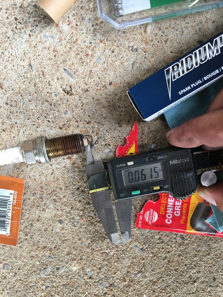

    Honesty....the OE plugs are good for better than 30K. The 30K interval is mainly for CA trucks to ensure CARB requirements are met.

    I didn't chang mine when I should have and when I did I found just how much the wear on the gap was. Factory spec is .44

    The thing im aggravated is the service history says they were changed, but obviously not! Your better off doing things yourself! All those things I did today are easy maintenance items if you don't mind getting your hands dirty! :)

    A buddy of mine told me that the dealership (Toyota) changed his with all new denso plugs, all the same brand! So I think it's factory plugs I changed at 75k!!!! Ridiculous!

    Mine is like a completely different truck like truly! The throttle body was horrific, air filter was nasty, and the plugs were original! And all my fluids were black when I changed them! ... Truck feels 100x's better now!

    Unless you are running Iridium Tipped plugs you should change the plugs by schedule every 30K miles.

    Because someone didn't take care of the vehicle, and bother changing the plugs on the regular intervals...
