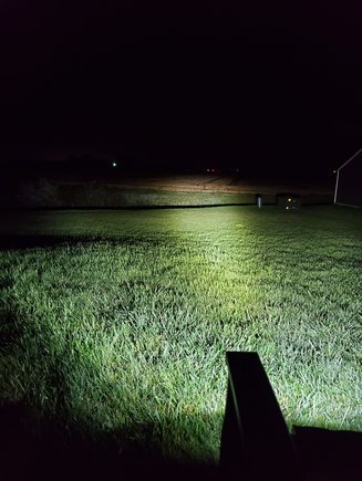

    This picture has been posted before but I can literally drive 80mph (I mean the posted speed limit) with just the two sets of DD Maxes on with complete calm with the vision provided...
    but being here has made me greedy, I want even better. The DD max driving are great, but only as long as the air is clear. With snow, fog or rain that isn't thick enough to causes issues running with the high beams on definitely cause lots of backsplatter with the maxes on. Fortunately even though they are activated by the high beams I can still switch them on or off separately. Also for those times I can't run the brights I'd still like more side and distance lighting on low. Before coming here and the Daniel Stern articles I thought running the fogs 100% of the time was the answer. There used to be auxiliary low beams but my searching doesn't turn anything up. Soooo, I got thinking. Looking at this DD image

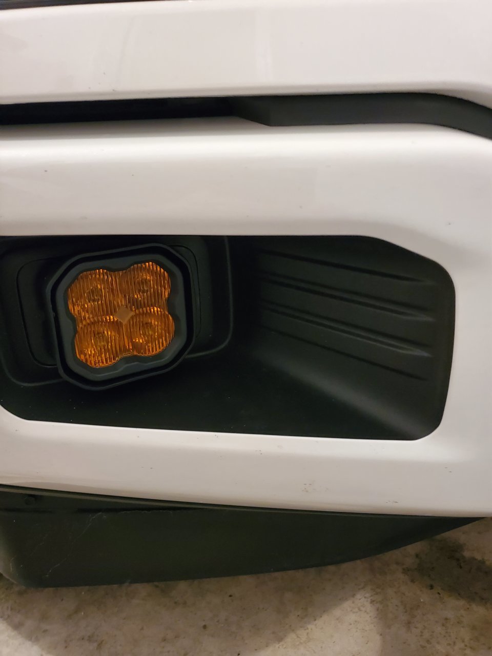

    and this one knowing my driving lights are supposed to have a 18 x 8 pattern....
    which means the vertical spread is almost the same as the SAE fogs is there any reason (other than not really legal) that I couldn't mount them low either by the fogs with the KDF dual mount, or in the intercooler opening on the standard mounts with them aimed at the same height as the fogs and maybe toed in so they cross and give me a wider angle??

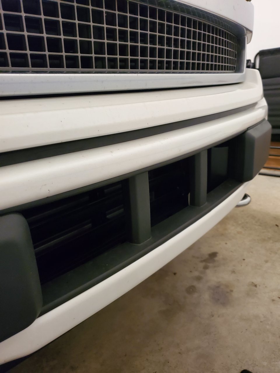

    I'm thinking (actually hoping) that with the sharp defined cutoff of the S3 SAE driving lens it they shouldn't be blinding oncoming traffic. I could either move the max driving currently on the SDHQ mounts to one of the spots or maybe get selective yellow pro driving and put the clear spare driving lens set I have on it and have a halogen color looking set. Is there any reason this shouldn't work?
    Then if that works I'd like to improve the already great hi beam/ SS3 driving combo. If I moved the maxes down low I need something else for the SDHQ mounts. IF we look at the specs of the DD SS5 pro yellow spots they have a 20degree spread which is actually 2 degrees wider than the max driving and 227000cd compared to the already phenomenal 98000cd of the max driving I have sitting there. Am I wrong thinking I can have a color that will cut through some glare, just as wide a pattern and over twice the candela. Or in a really strange twist the sports have 360000cd but a slightly narrower spread of 15 degrees. The only downside I see to the swap on the A pillar is the vertical I have now is 8 degrees and the wider vertical on the SS5 even with spot lenses may cause too much glare on the hood?
    Please, being serious, tell me where I'm freaking nuts in my thinking here? Have to figure this out quick because the sale price for the DDs with Colton ends the 5th.

    There is also the BD dual 10" S8 kit that I originally got but returned It goes in the grill opening at a level splitting the highs and low beams. but I'm not sure there output is worth the trouble of removing half the front end. There's no way with their beam patterns that I could run them with the lows but they would get the hi beams scatter out of my line of sight. Mounts like they belong there in the grill opening.
    This is only 1 of the lights but not sure they're worth the effort compared to the DDs. But they actually don't have to be an instead of, can be added to.
