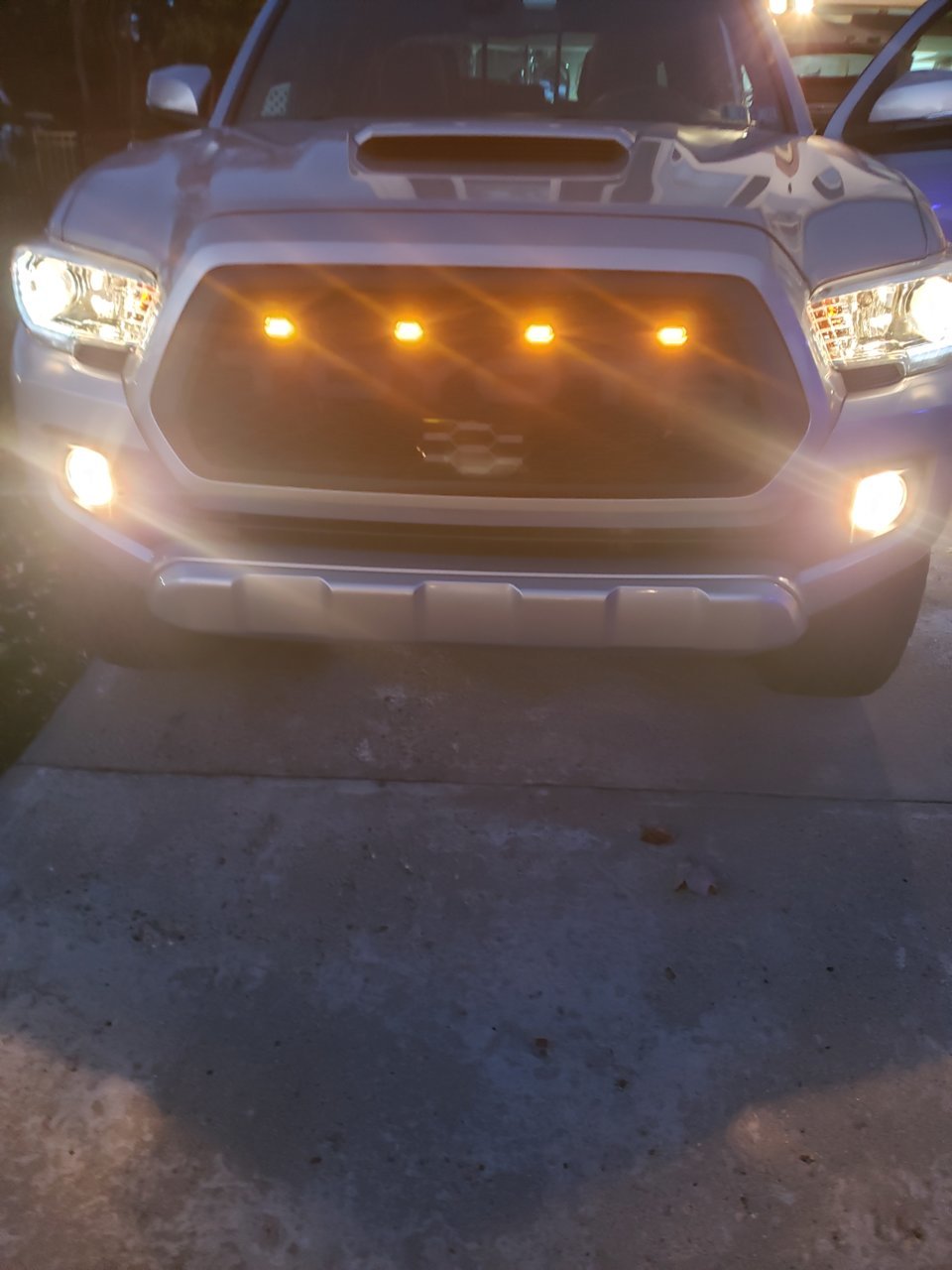

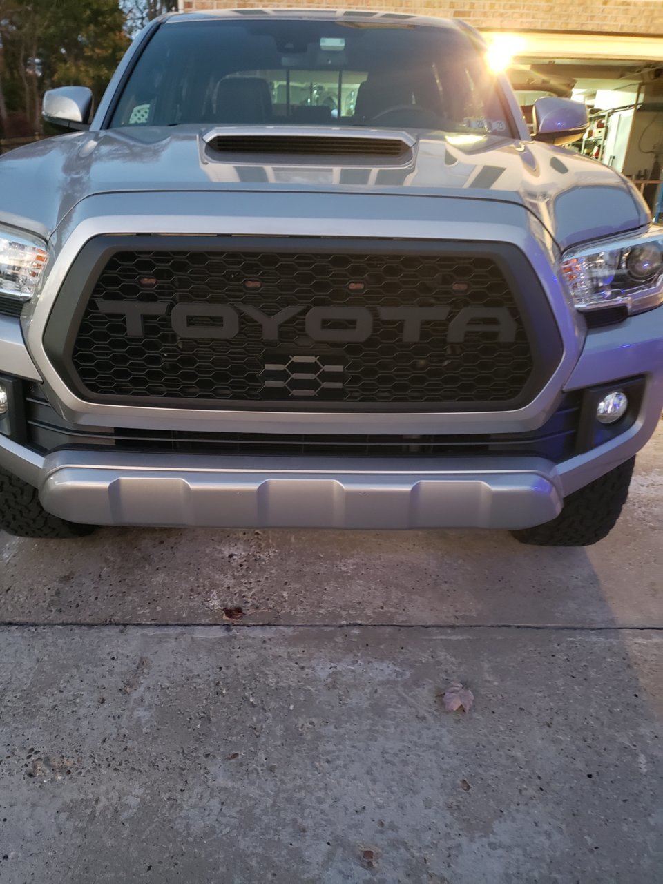

    Well after about 1500 miles when I got back from my trip the next morning I started my truck to go to work and the problem is back. I guess I will keep trying to figure this bullshit out.
    Not the pro grill, but the pcs is moved to the approximate same location. I was having multiple lights and messages. Pcs malfunction, brake light, abs light, and traction control. I messed around for a week or so with washers trying to adjust my sensor. Finally I took all washers out and drove it for a day or so. I was still intermittently getting errors. I took my negative battery cable off for 20 minutes or so before we drove for approximately 700 miles. I used my cruise control the whole trip and so far not one time have I gotten any lights or messages. Hopefully my issue is fixed. The reason I went back to no washers on my sensor was that I didn't get the failures as often with that set up. When I first installed the grill I didn't have an issue until the 3rd or 4th time I drove the truck so probably the next day. I tried 1, then 2 then 3 washers and the problem seemed to get worse each time so I went back to 0 washers. I would still get lights, but not as often and sometimes I could restart the truck and get rid of them. So I figured let me try disconnecting the battery and do a reset before this trip and maybe between that and a road trip while using the radar cruise it will recalibrate. Like I said no issues the whole trip. Hopefully this will help some of you fix your problem.
