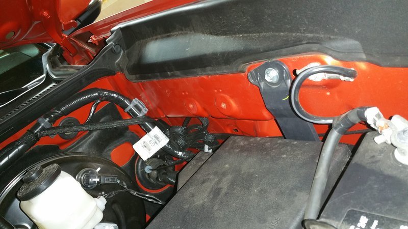

    Please tell me what size bolts are needed here. I've tried everything I have. I seem to have it close but with the wrongs threads. Anger. Rising.

    M8-1.25 x 30

    Thank you.

    That was what it was on 2nd Gens.....I'm sure it's the same.

    I would like to know too.
    And I too have tried several screws and bolts in my junk jar. None fit.

    If it's that big of a deal and you have a tap set you could always retap it to a size you have
