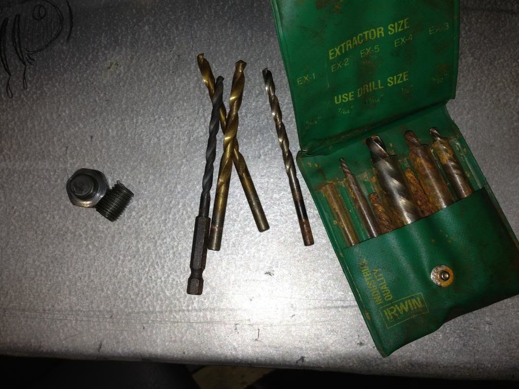

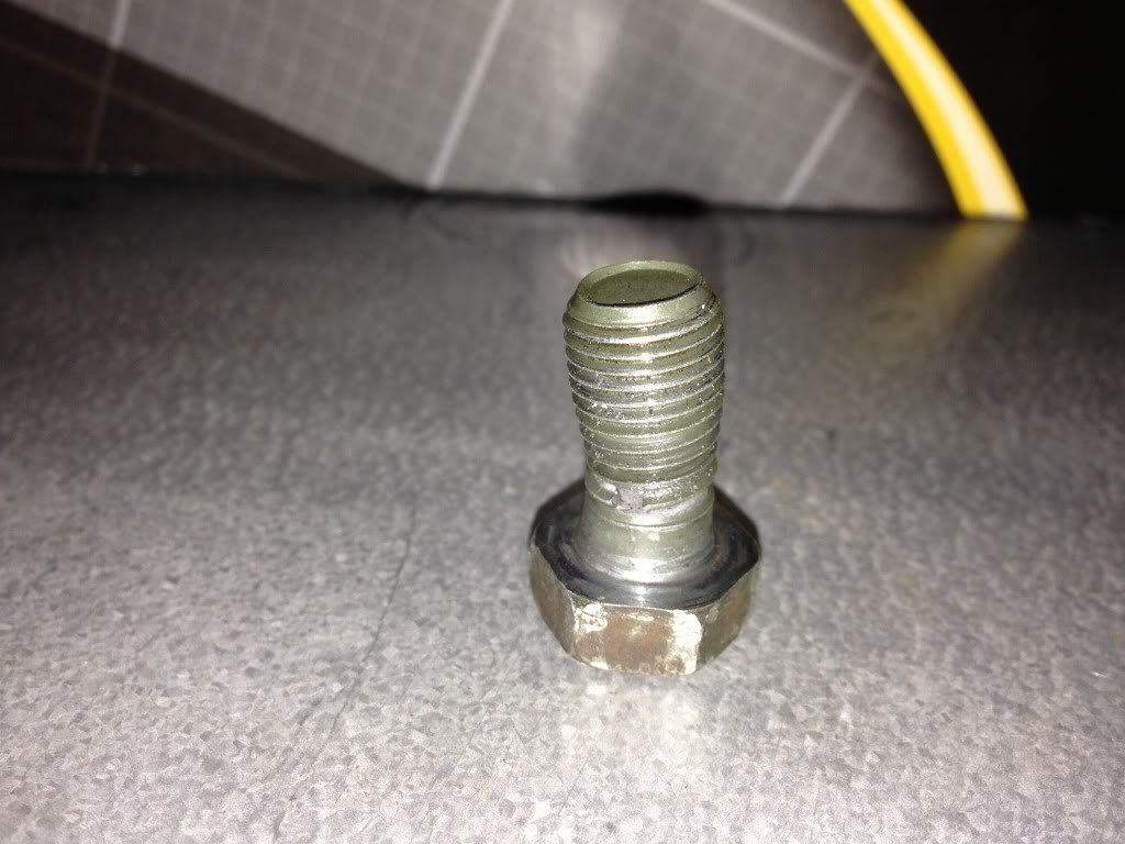

    i know u should tourqe you crap down but u know tight then a nice tug once more is good enough for me, when ever i have used a torque wrench this has happened!! i hate them with a passion!!!! this thing got so stretched out!!
    thanks god for a friends come along set!! and my local shop imm saved my ass again had an extra bolt for me!!
    seriously saved my ass..
    i was installing the top nut and snap!! mother #$@@ piece of s*** stupid torque wrench!!!
    i know people always say torque your crap down but i aint ever using one again!!
    got the icons installed smooth as butter lover em!!

    i torqued all three bolts and it was clicking just fine and i started doing the last one i was like what the crap this is taking way to long to get tight and just as i was about to stop snap!! ive just always had bad experiences with torque wrenches and i set it to 35 ft pounds. as that was stated on another forum for those bolts.
    i know that a torque wrench is a very important tool just venting lol this is not the first time this has happened lol... my grandpa say he always hate those things. just do it the old fashion way son haha im going to start listing to him. or be more cautious when im using one. it stretched the bolt out until it snapped

    and i have all snap on tools but not my torque wrench i was using its a buddys i thinks its craftsman. was working just fine untill the last one. should have stopped torquing down sooner it was telling me to stop lol i didn't listen to the tool.

    threads were clean threaded just fine not cross threading.. it came out very easy once i got it drilled out. and i was 35 foot pounds as i read somewhere else that that was the spec for the bolts

    thats the thing it didnt even feel like the bolt was tightening down at all was easy as pie that's why i kept going..... live and learn
