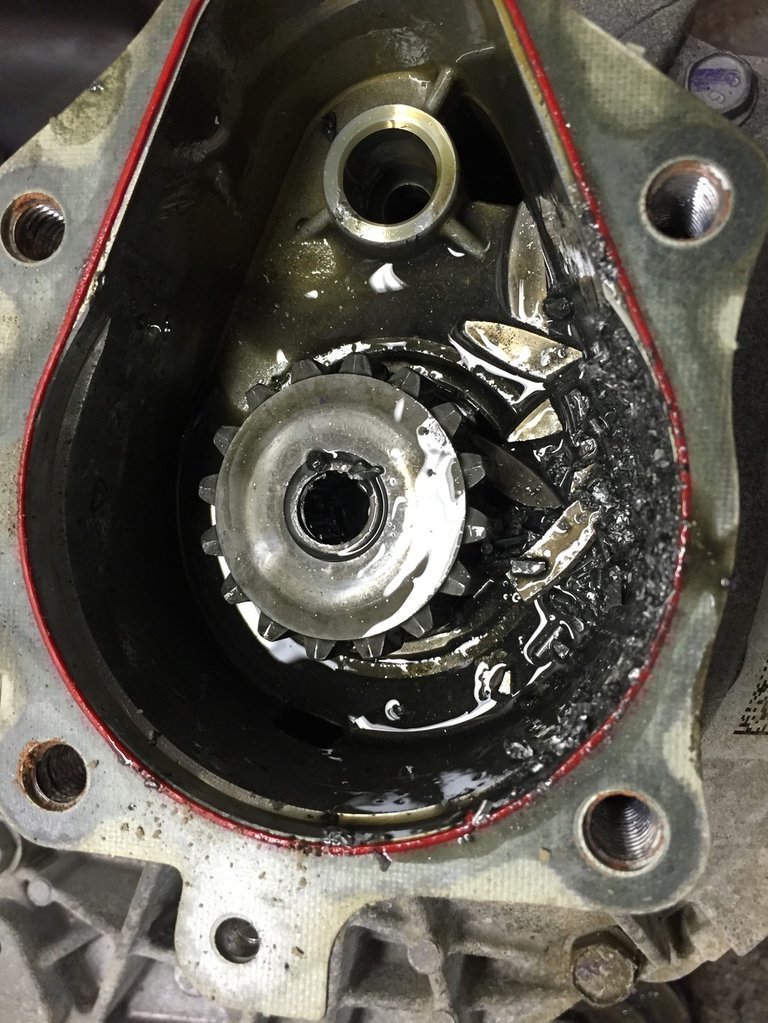

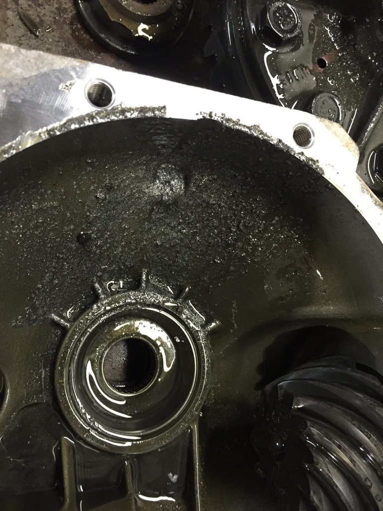

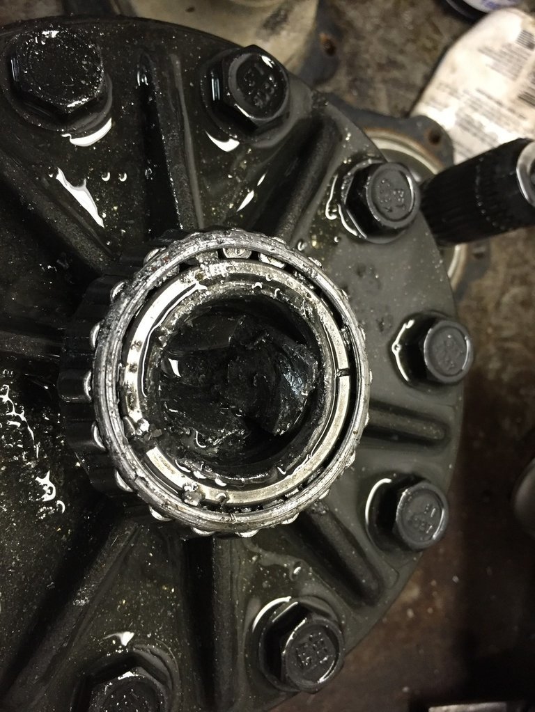

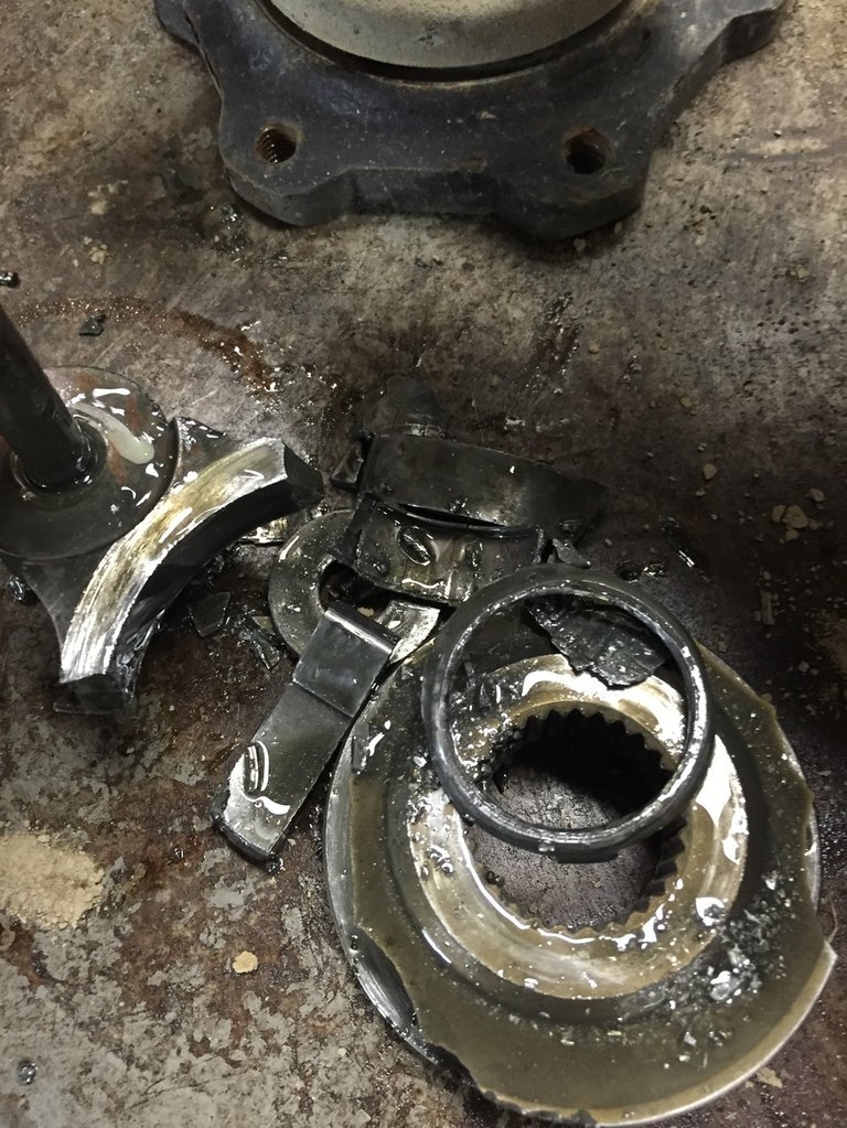

    Not a tacoma. But I've seen numerous threads where people have talked about driveline bind while driving around town in 4wd. Here are the consequences.

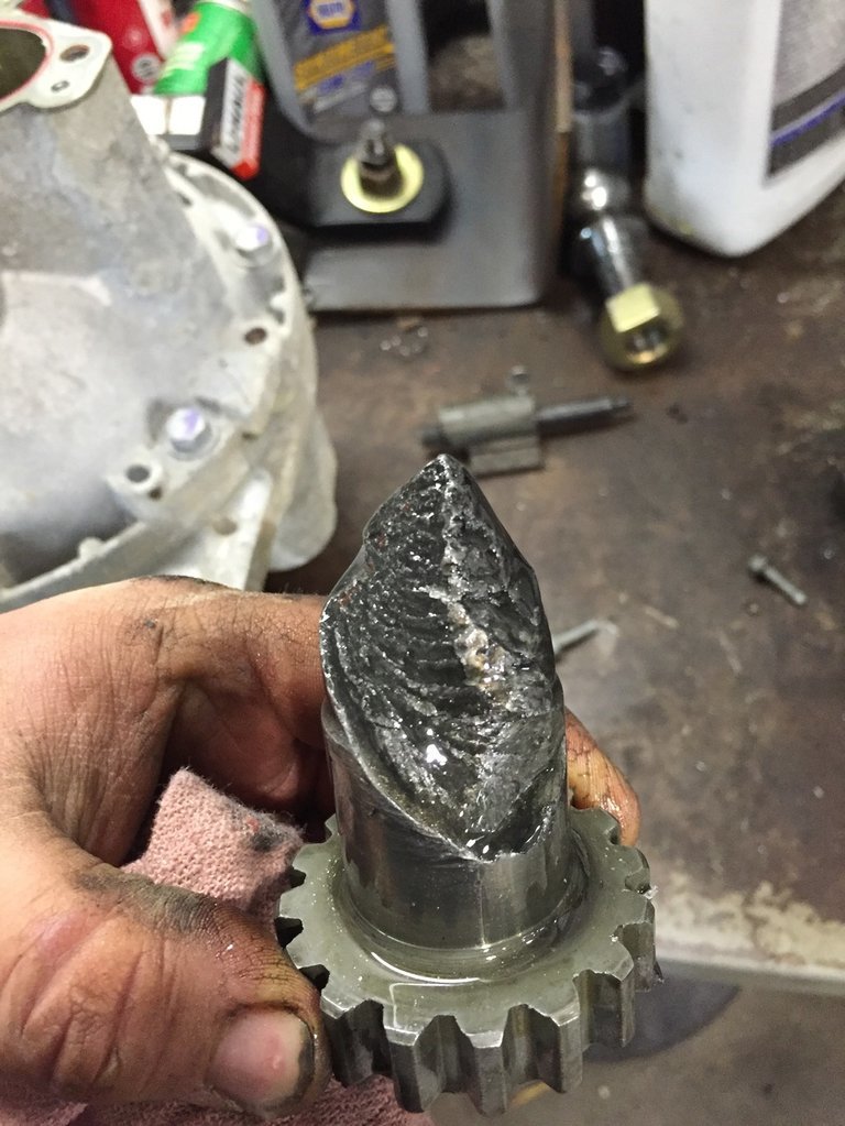

    that guys hand is quite a "claw".

    Only the case, LF stub axle, and pinion yoke are savable. Everything else is junk

    thats my hand. Working in a shop will tear your body up. I'm only 24.

    2013 NBM AC 4.0 4x4 Auto OR
    probably left in PT 4wd for a long long time ?
    short durations of that shouldn't bust one open
  14. Jan 25, 2016 at 2:04 PM
    Aussiek2000
    Aussiek2000 [OP] Well-Known Member
    Sep 5, 2015
    #163499
    5,652
    2016 Offroad AC
    a bind on dry pavement is a bind. Doesn't matter if it was engaged for 5 seconds or 5 hours
