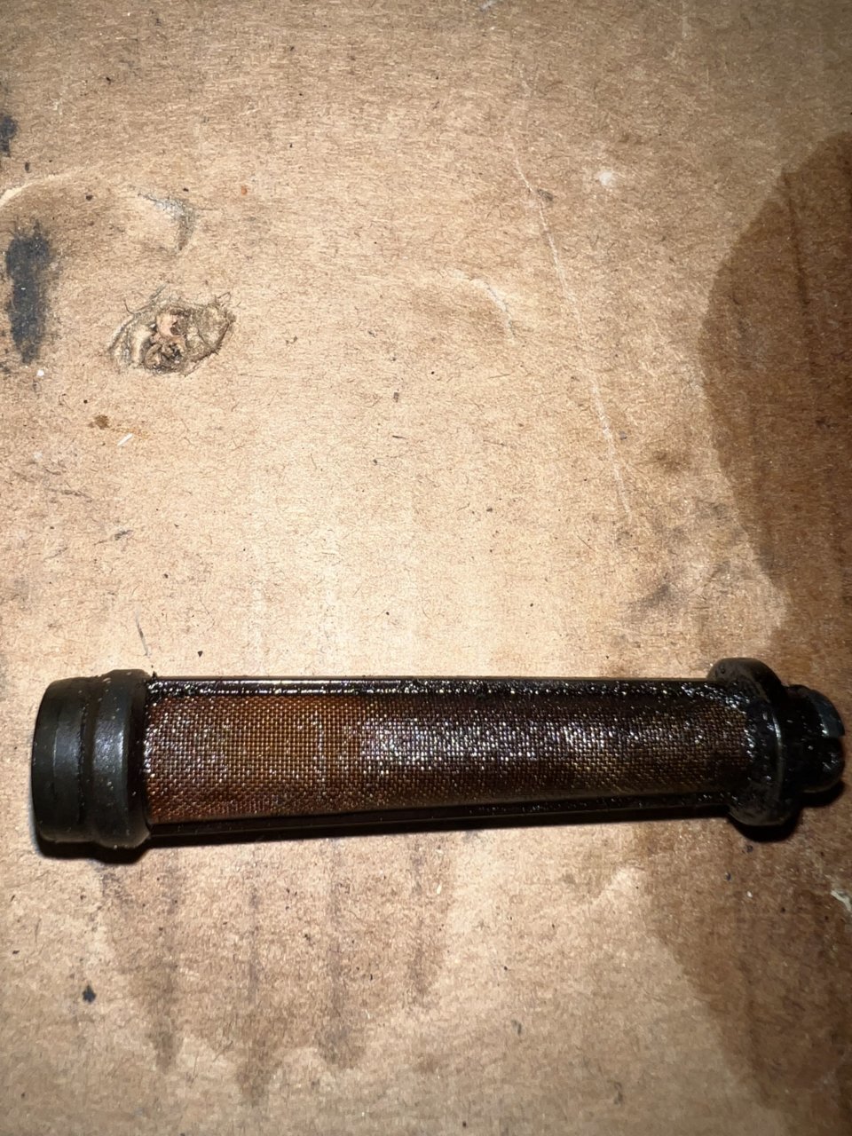

    Resurrecting an old thread:
    I replaced both screens the other day. My Tacoma has 479,800 miles on it. My oil change intervals have been every 10,000 miles with synthetic oil.
    • for both sides I was only able to break the bolt loose with a 1/2" breaker bar. 3/8" socket set up would not budge them. I could have used an impact gun but did not want to risk that.
    • You can gain access for each from the fender well, using many 1/2" socket extensions. It's a 14mm socket. I removed the tires also.
    • The passenger side is definitely easy to do
    • The drivers side is a pain due to the alternator. I tried just "swinging it out of the way" as azzwethinkweiz suggested but it did not give enough clearance for the 1/2" swivel socket setup needed to get on the head of the bolt. Wound up dropping the skid plate, removing the serp. belt, removing both bolts for the alternator and all wire harness stuff so it could drop downward low enough for the clearance needed.
    • The skinny end of the screen fits into a hole on the backside of the bolt.
    • I agree with what others had said. If you change the oil every 5000 miles these should never have to be touched.
    • Here is what the original ones looked like
    Hope this helps someone

    Did you replace them because of a degradation in performance or just as a maintenance item? Any noticeable improvement after install?

    maintenance and twice in the past two years I rcvd an error code having to do with the Oil control valves. I've not tried to remove the oil control valves yet and that error code has not popped up in I can't tell you how many months. Figured these were easy enough to do so I might as well.

    Runs the same as it did before which is excellent

    Caught if before it gummed up the actuators. Very good.
