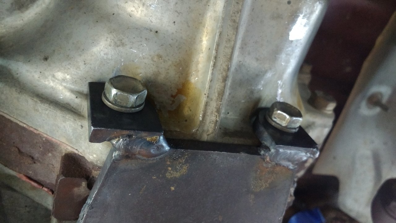

    I just finished pulling the transmission to do the clutch in my truck and made this useful floor jack adapter to get a good hold on the transmission. The adapter made pulling the transmission pretty easy, and steering the the transmission around the exhaust flange wasn't all the bad either. Anyways, here is a picture.

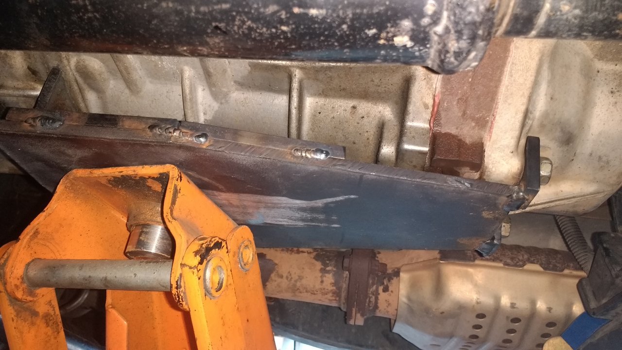

    The adapter sits in the floor jack and bolts up to the transfer case. The front of the transmission just before the bell housing sits in the vertical plate at the front of the adapter. The steel welded along the edge prevents flexing in the plate. Here it is all hooked up.
    Obviously, the pin that sits in the floor jack receiver is positioned quite far forward, but this is because I had two jacks and could place one in back on the transfer case for added support and control. I am confident the job could be done with one jack by simply welding the pin further back as the transmission was resting on on the adapter alone at times. Here is a picture showing how both jacks were set up.

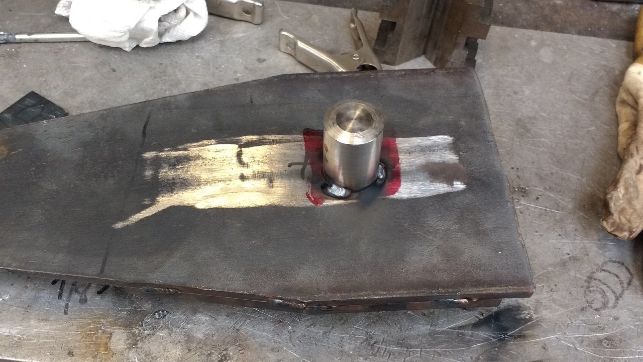

    I made this adapter just fitting everything by hand. No measurements needed and definitely worth it for the added control and stability over a transmission jack or a standard floor jack without the adapter. If you have any questions on making one yourself, or would be interested in buying one. Let me know. I wouldn't mind making a few more if you guys would find this helpful.
    Some additional pics:

    I can make it any size you want. Just give me the dimension on your jack. I believe most are 1&3/16.

    1018 on the blot flanges. I used a plasma torch to cut the rest out of 1/4 inch plate I had laying around. The reinforcements were just a mild tool steel I also had around the shop.
