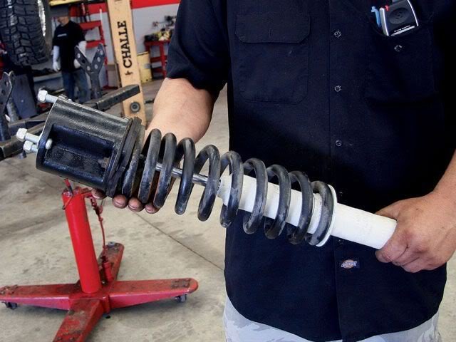

    this is what it looks like, (this pic is an 04 or older tacoma same concept though.)131_0810_06_z2001_toyota_tacoma_trd_exte_f3ff57bbd8f84c0a7e88185d64964a87c968771d.jpg
  16. Apr 7, 2012 at 5:33 PM
    #16
    TeamSarcasm
    TeamSarcasm Flawless Escalation to the Ludicrous
    Feb 20, 2011
    #51510
    11,000
    The better coast
    Are you 4x4?
  17. Apr 7, 2012 at 5:33 PM
    #17
    MXscott14
    MXscott14 [OP] Bartle Do Member
    Aug 11, 2010
    #41541
    406
    Keith Stone
    In Front Of You
    2006 2nd generation antique
    Black Headlight, Foglight always on,
    where can i get better shocks?
    and what size do i need?
    is this the problem?
  18. Apr 7, 2012 at 5:35 PM
    #18
    TeamSarcasm
    Feb 20, 2011
    #51510
    11,000
    The better coast
    So.....4x4?
    And personally I would just ditch that lift. Buy some used shocks and take the blocks off the back. (I'm assuming its blocks...)
  19. Apr 7, 2012 at 5:36 PM
    #19
    the.sight.picture
    the.sight.picture Well-Known Member
    Jan 22, 2012
    #71180
    3,639
    Nick
    Warren County VA
    2018DCSB TRD Quicksand
    Emu 887x Nitrochargers Dakar Heavys, 255 85 16 ST-MAXX
    sell spacers. get CO's. or ome. problem solved:D
  20. Apr 7, 2012 at 5:36 PM
    #20
    TeamSarcasm
    Feb 20, 2011
    #51510
    11,000
    The better coast
    Yeah basically haha.
