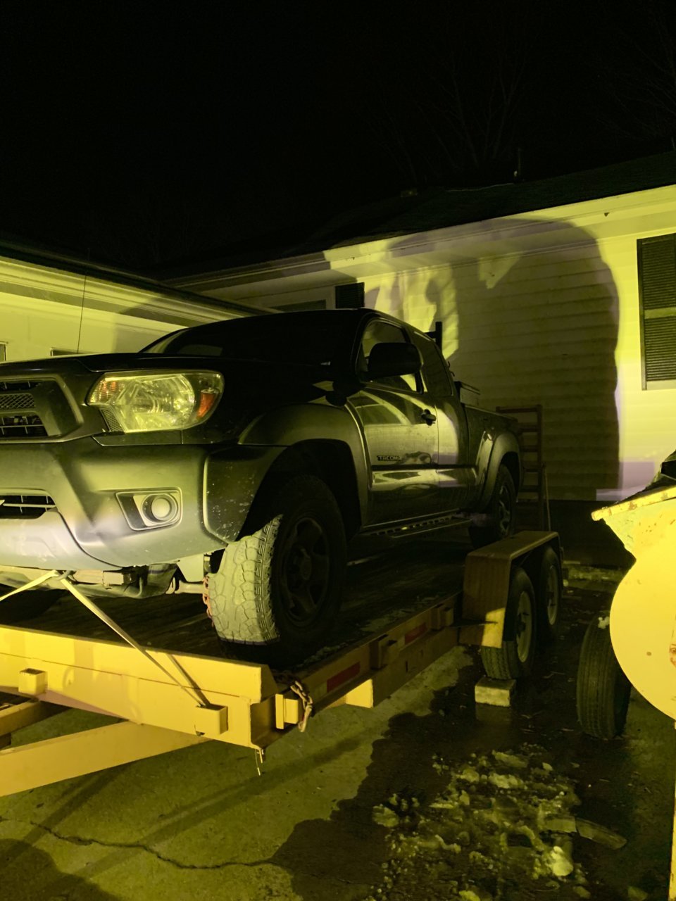

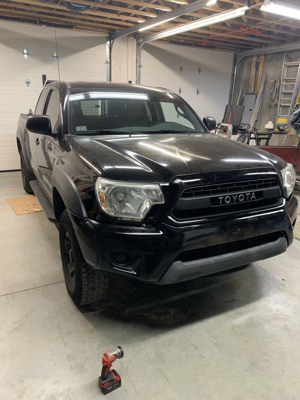

    This sweet little taco ended up in my driveway last week after it’s previous owner over heated her....

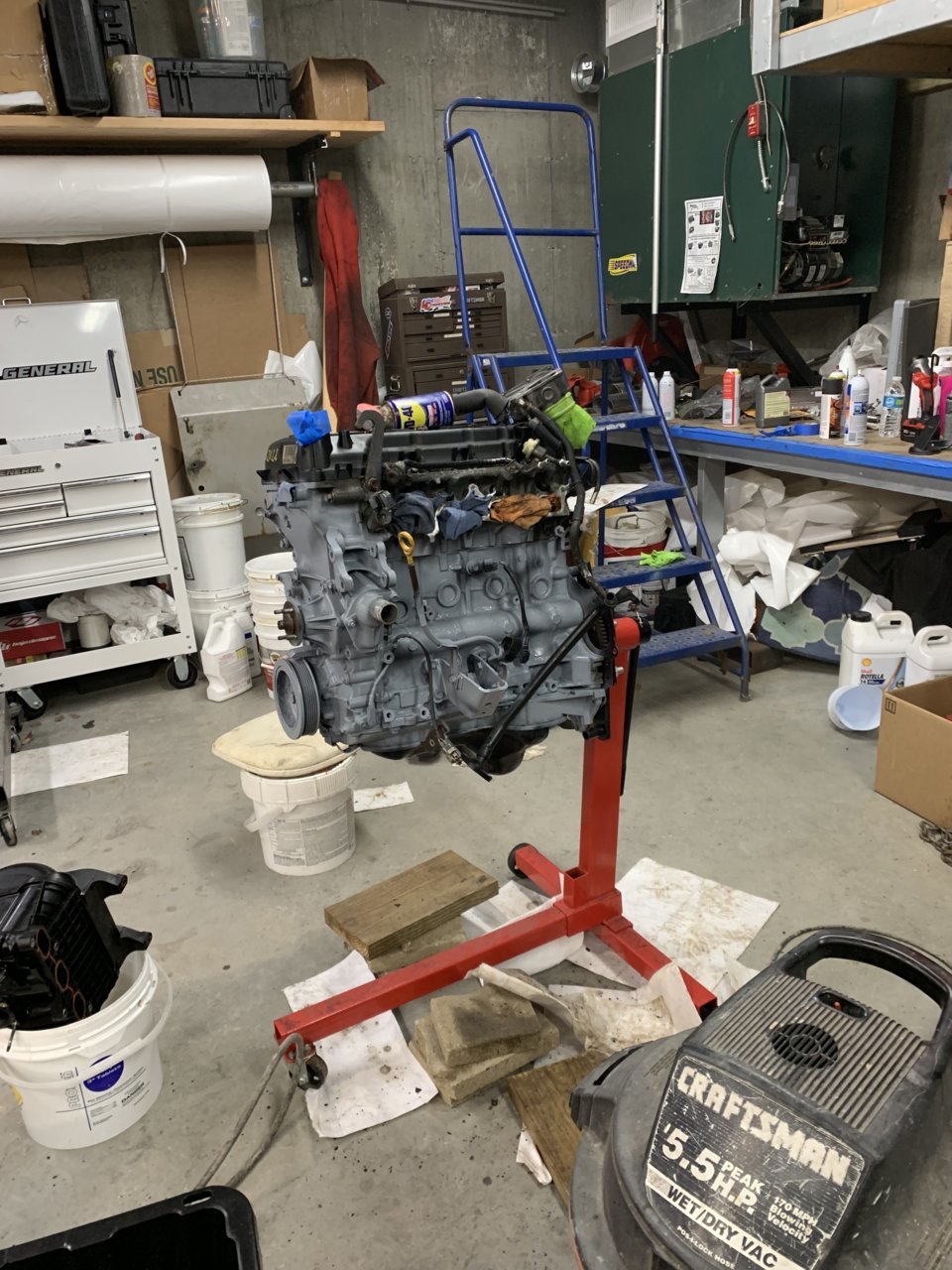

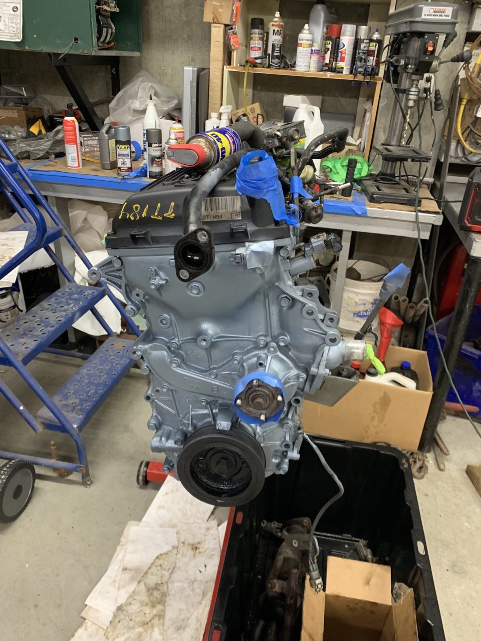

    91A664D0-94B1-4EF3-8B11-73B96B92B4EE.jpg More to come i have a new motor ready to drop in once I put all fresh gaskets on her
    A few hours of brushing and quick primer fog she’s looking much better. I ordered all new oem gaskets, hoses, and studs/nuts for the intake and exhaust so I figured I have enough time to paint her up. Hopefully that helps fight our salty winters off better.

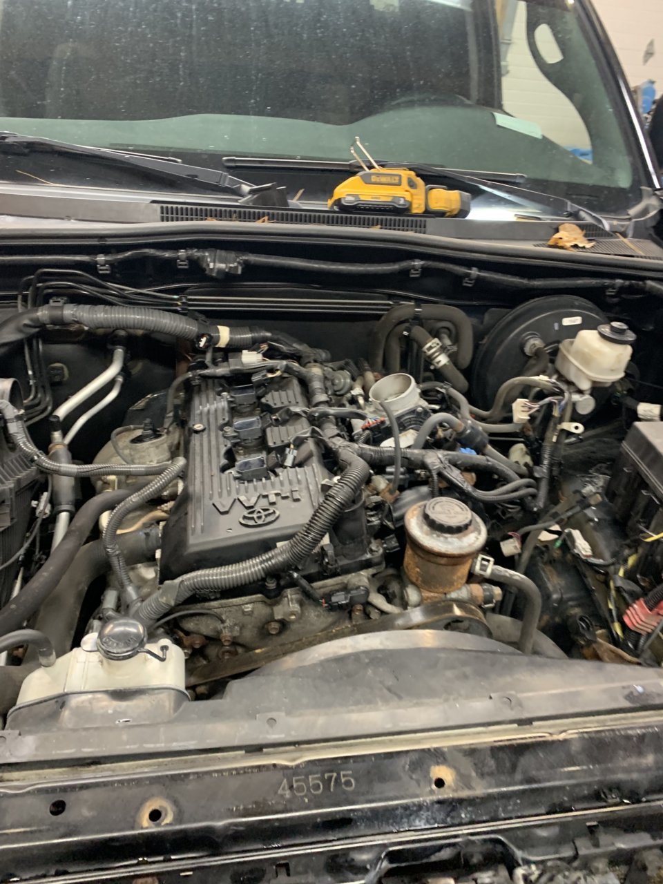

    now that she’s running theres a few TSBs I’m going to take her in for and I’d still like to clean the interior up a bit either a new drivers seat or maybe some seat covers

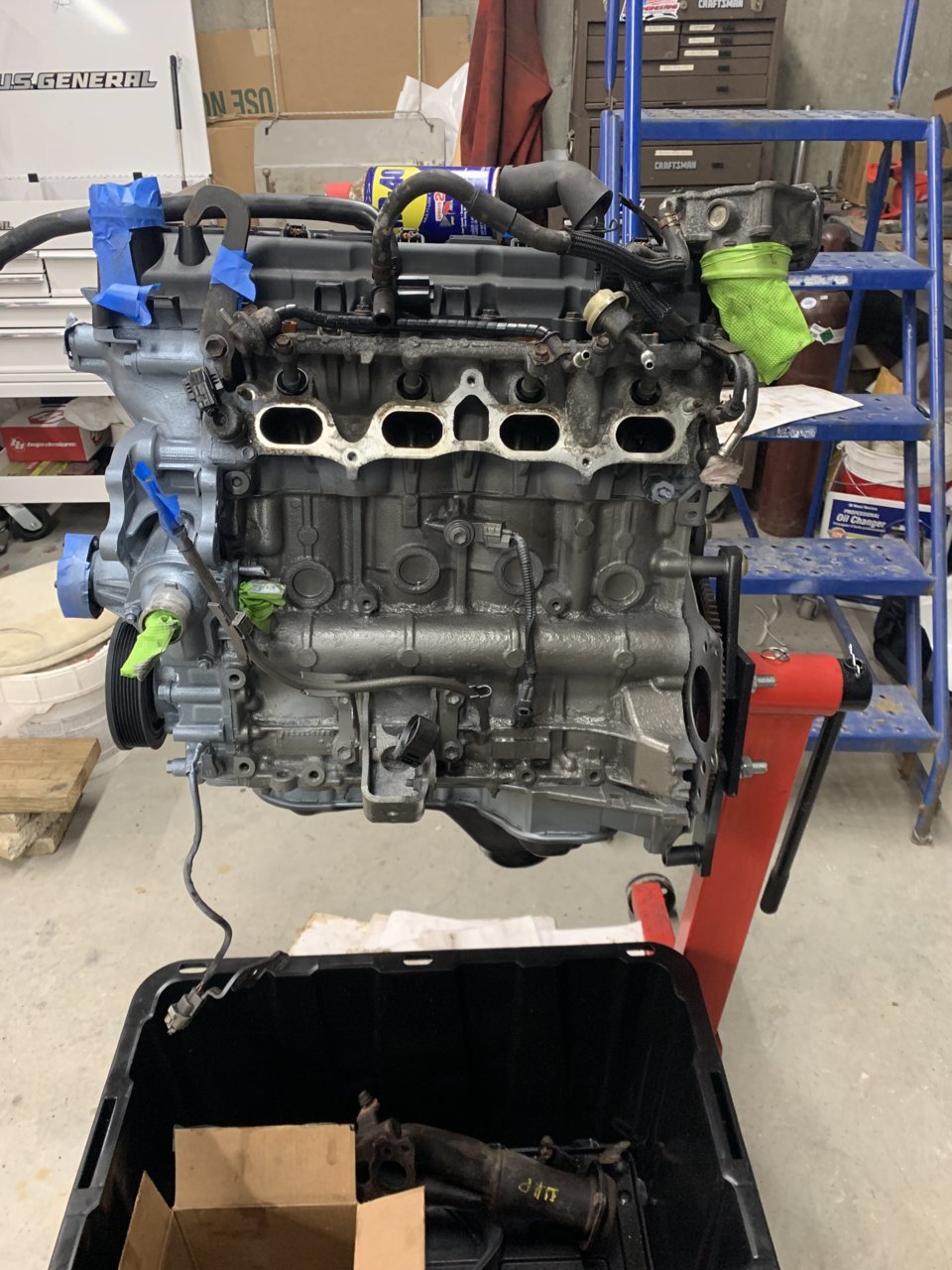

    Came out pretty good. I’m just going to clean up the head because the aluminum is in great shape. 98B88FC1-31A5-44BE-AC5D-7E23BED7FB5F.jpg

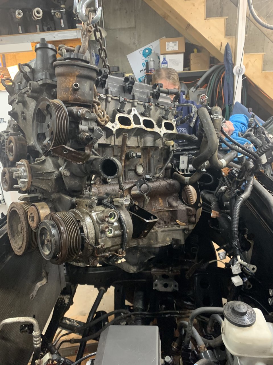

    It’s going down all connections undone and radiator getting drained is the goal for tonight. Gotta figure out how I’m going to access the motor mounts

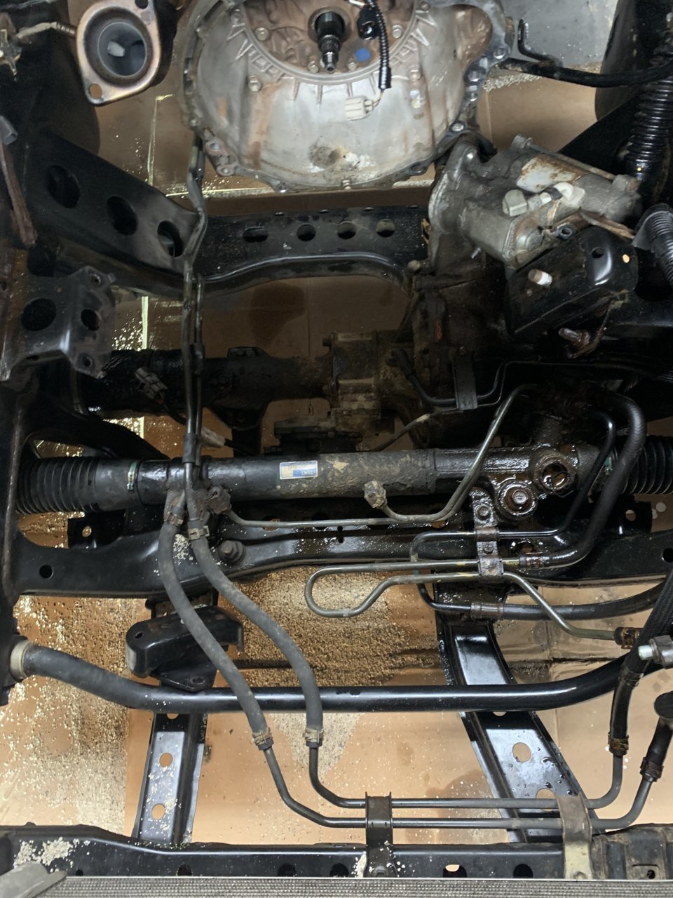

  16. Dec 13, 2019 at 4:07 PM
    #16
    Jcyr
    Jcyr [OP] Midnightthetaco
    Mar 16, 2017
    #213447
    3,280
    Jack
    North east
    3RZ 04 4x4 black ext cab
    2.5" lift king/total chaos Skids sliders rear tire swing
    4B37C81A-3638-4731-BC92-346DE3E3CD78.jpg Smooth sailing from here
    tacobell007 likes this.

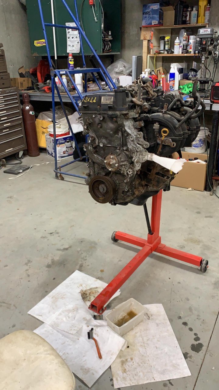

  19. Dec 14, 2019 at 12:53 PM
    #19
    Jcyr
    Mar 16, 2017
    #213447
    3,280
    Jack
    North east

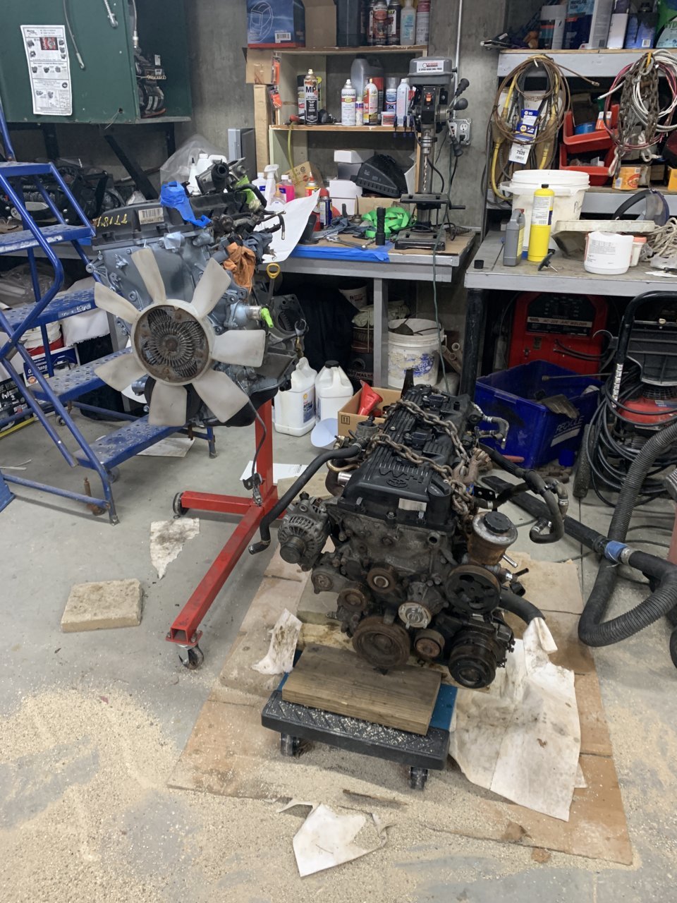

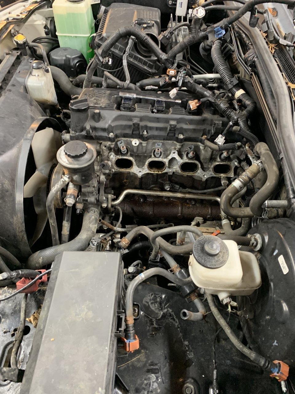

    Now time to transfer alt ps pump and ac to the new motor. Unfortunately I’m still waiting for some new idler pulleys and intakes/exhaust gaskets. While she’s out I’m addressing anything that could be worn.
    I’m also going to clean up the front differential and surrounding areas and right before the motor goes in I’ll fluidfilm the inside of the frame and crossmember
