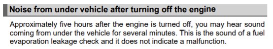

    For what it’s worth, mine buzzes while it’s on. There’s no way it’s normal, It sounds like someone lost a vibrator in my fuel tank.
    here’s a crappy video. It’s somewhat intermittent, but theres a buzzing coming from the tank. Hard to hear on camera but very noticeable in person.
