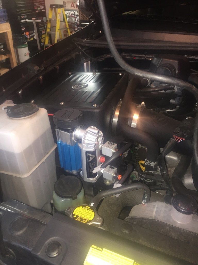

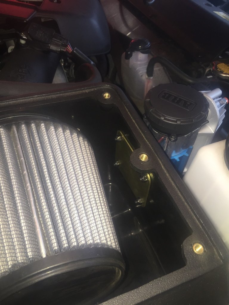

    Well, you talked me out of it. I mounted it on the side of the AFE air box.
    You're right, it'll be much sturdier.
    C101061C-EBBF-41E1-A7B5-94E8FA9A7720_zps_ea68399ed736884611d22a467d383e6b746f205c.jpg
    00D8110F-854A-4F63-BED6-E01F06A1254A_zps_0c7b9a3a7f02daa6c4f1af4b54f723450ca9ecb7.jpg
    I now have both Diffs and the driveshaft back in, and the compressor installed and plumbed. Only thing left is the wring for the compressor.

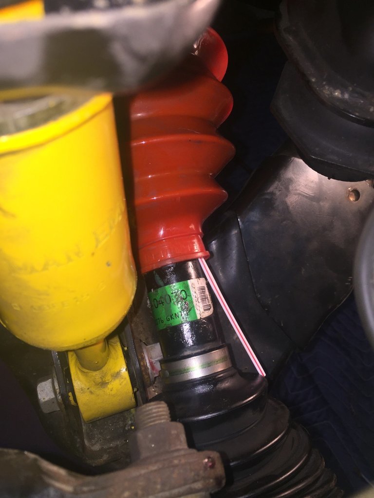

    probably common knowledge, but here's a little trick when installing CV boots.
    Even though I know better, i grabbed right onto the inner boot to guide the axle in. Of course, as we'll know, that pushed the pleats in and I couldn't pop them back out...
    So, the fix? I took the clamp back off and stuck a little stir stick in like so:
    550DBB3C-5F23-44A4-A9FE-D5CE8A5CC8B9_zps_593048274c6886f0319e9019e2e5bfdde64756ca.jpg
    Once the air can go both ways, the pleats pop right back out with a little manipulation.
    If I were smart, I would've put the stir stick in when I initially installed the boot. Obviously, you pull the stick out once the boot is installed. Next time...

    I bought a rebuilt axle from CVJ a few weeks ago. I opted for the red HD high angle boot at the time. I was impressed with the red boot, so I ordered another boot for my other axle.
    That's how I know about the stir stick trick. The rebuilt axle from CVJ came with a little tube installed in the same place I put the stick. There was a little note that said to remove it post install.
