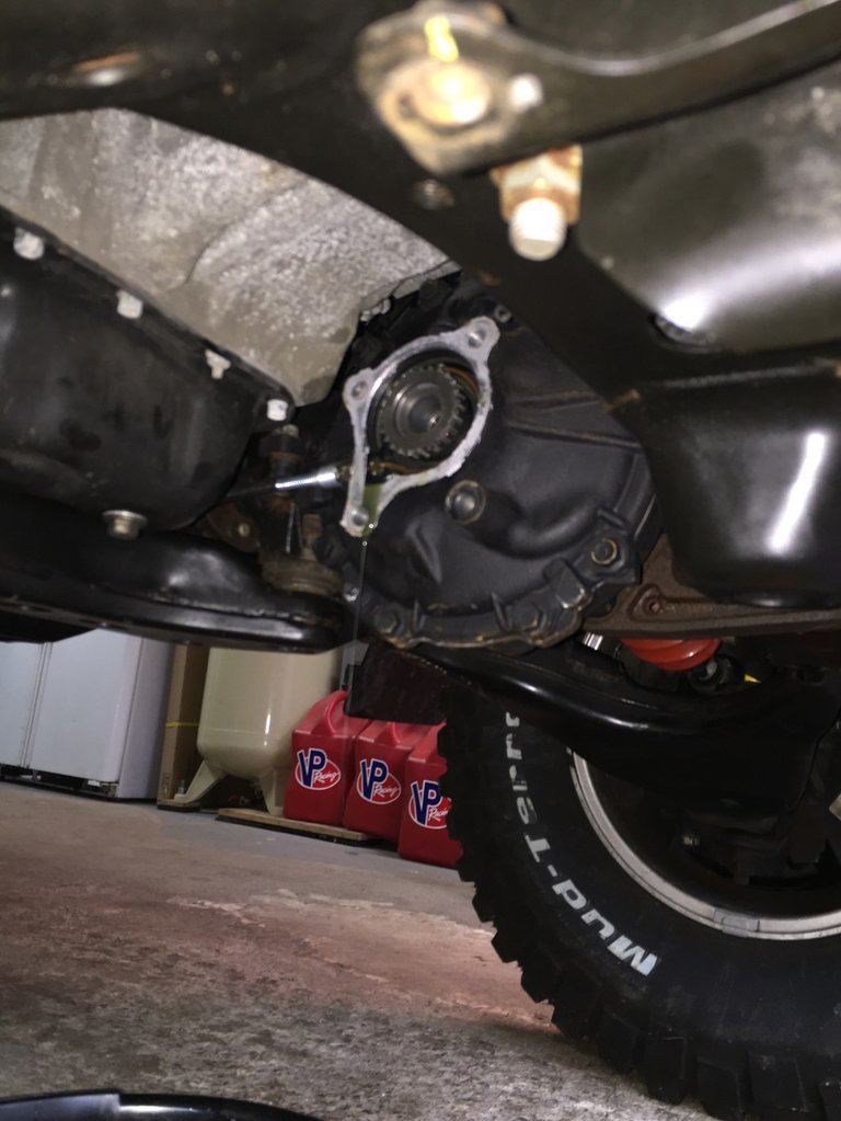

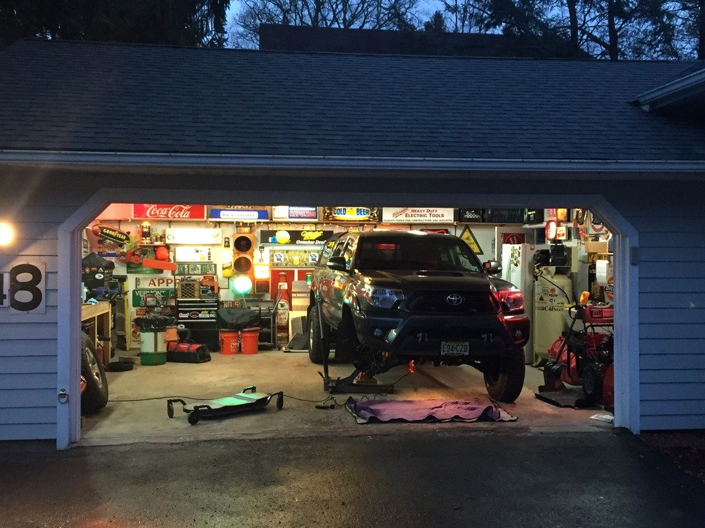

    Yup, it'll work a LOT better now. On a good note, I'm getting really good at changing axles...
    2A4EBFE1-8DDF-43E9-94C2-9BDAA7668AB5_zps_219f26d6d81ff35e164156036577a2241f79fd20.jpg
    This has become WAY too common a sight the last coulple of weeks!
    8CE14EF8-DE04-4C58-92DD-26FBE52C1692_zps_c3449926b2b7b233c4572b30e289f7ae1739b9c9.jpg
