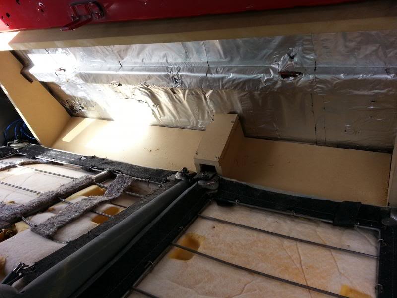

    Okay, I'm going to preface this build by saying I have a bad knee right now. I'm off work except for a couple hours a day. So this will be slow.
    I have a couple pictures so far, here's the first.
    Okay, at the bottom of the side pieces, the back of the truck rolls in a little. To account for this, you need to trim the side pieces, or sand them, like I did, to get a nice round curve, not a straight back. It smooths in nicely, maybe a .25", nothing to freak out about.
    Here's all that I got done today so far, I may be able to get more done after icing and heat on my knee for a while, as well as some Advil, we'll see.
    Fully framed in, with the cutout for the seat bracket in place. That part's a little more tricky, as if you look at the back of the truck, it "ripples" or has a stamped pattern in it, to give it strength. Careful cutting and sanding will get you the right fit. Just make the pieces a little big, and sand them down a little at a time. I used a sanding roller on a dremel, but a palm sander may work.

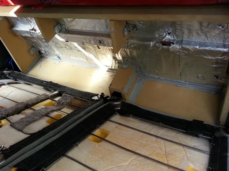

    Hopefully, my knee will let me screw and silicone tonight. I'd like to get it in there firmly, and see what kind of screwups I made, and have to fill with extra silicone.

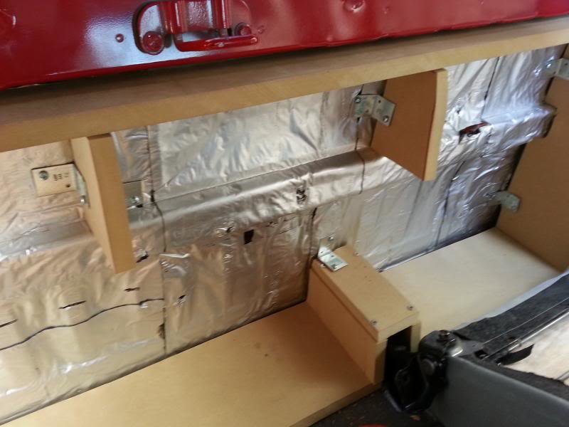

    So, today, I had to run an errand to Home Depot for the wife, and all the walking in that store played a number on my knee. So I didn't get as much done as I'd like.
    I did bevel the back edges, to get it to sit flush to the back wall, much tighter fit now. Then.......
    Glued and screwed. Glued together all the parts of the box, and screwed it to the back wall with about 12 brackets. It's on tight, and not going anywhere.
    Then..............
    Siliconed the hell out of it. It's sealed tight once the silicone cures. Until then, my truck stinks, but in the end, it'll be worth it, having 12"s back there. Tomorrow, the baffle goes on, and the wiring can begin. I have to mount the new amp, good place under the passenger seat, I already flipped the bar that's there. Let me know what you think?
